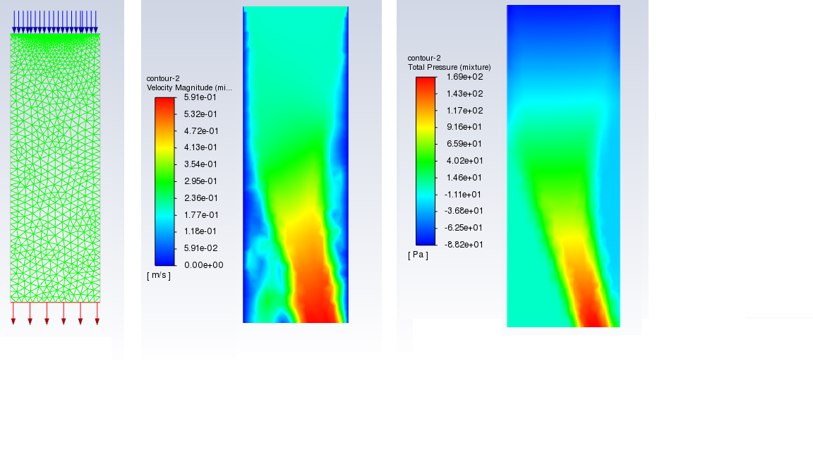

I want to simulate a simple 2D rectangular with transient time, VOF (air and water), and laminar - viscous model.
I set up to pump from the top (inlet) to bottom (outlet).
The velocity was increased from inlet to outlet, and the pressure has the same results.
Is it incorrect? because follow Bernoulli's equation, when the velocity is increased so, the pressure is decreased.
But in my case, it is weird.
Does anyone solve this problem like me before?
Please give me some advice.
Thanks!

Subscriber"when the velocity is increased so, the pressure is decreased"
This conclusion is only valid in steady flows, with constant density and negligible mass and viscous forces. I do not think that your case is well-suited to these assumptions.
In order to help you, it would be interesting to see a general picture of the problem with the boundary conditions, as well as screenshots of the mesh and contours of some variables.

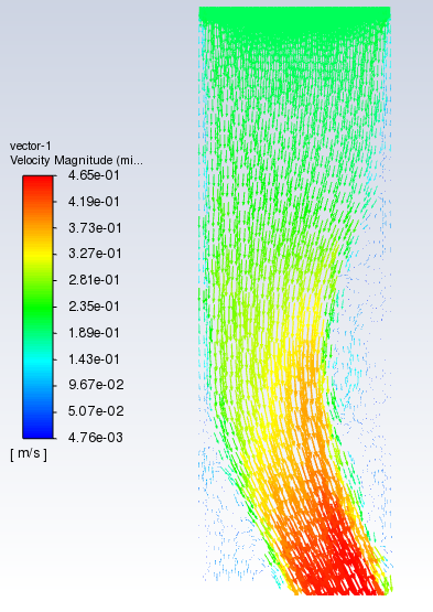

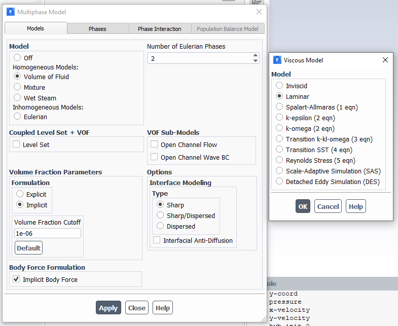

Ansys EmployeeModels used and velocity vectors.

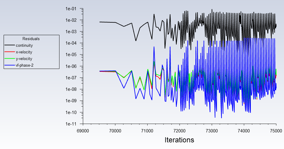

Ansys Employee+ Residual Convergence

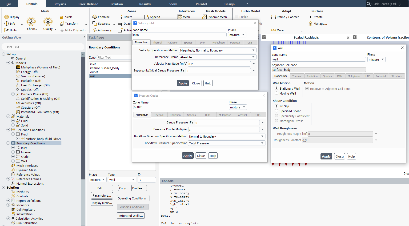

Ansys EmployeeWhat is the secondary phase boundary condition at you velocity inlet? From Velocity vector one clearly see how the jet is deviated and the presence of some "recirculation" zones which are affecting the orientation of the jet. I assume that is only a snapshot and the orientation / flow regime is changing over the time. In this kind of cases I never trust 2D runs and tend to directly use 3D and extend the geometry downwards using a sort of venturi diffusor or plenum it does depend on what you really have at the outlet.
