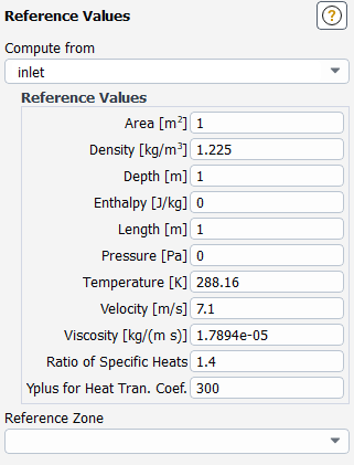

I am continually getting incorrect Cl and Cd values for my simulation. With some simulations, the value I get at 0 Degrees AOA my answers are within 1.5%, however sometimes are out by an order of magnitude.Â
My simulation is of an Eppler 908 foil, at this point, I am just trying to validate my model against data found on Airfoiltools database. Eventually, I would like to perform simulations of this foil against a multitude of AOA and velocities within water.
However, currently my simulation is in air, velocity 7.1m/s chord length 0.1m, this gives Reynolds number of 50000. I am using a C shaped mesh. For y+ = 1, my wall spacing was calculated to be 3.9x10^-5. I have attached images to show that my wall spacing is significantly below this threshold.Â
My settings for the fluent app are attached to an imgur link, as well as the expected output vs. actual output. Any help would be greatly apprecitaed.

Forum ModeratorDid you adjust the reference values? Check the lift and drag force too. It's very common to not get the area correct so the force is OK but the coefficient isn't. There are a few NACA airfoil examples/tutorials in the Fluent Help, they should explain what's needed.Â

Forum ModeratorAll coefficients are defined in the User's Guide, and most use one of the values you posted in that calculation. By Cp do you mean pressure coefficient, if so, yes it'll be affected.Â

SubscriberYes, I do mean the Pressure Co-efficient. If affected similarly to Cl and Cd, how will I calculate Cp?

Forum ModeratorThe Cp value come from Fluent - read https://ansyshelp.ansys.com/account/Secured?returnurl=/Views/Secured/corp/v231/en/flu_ug/flu_ug_fvdefs.html  and will tell you which reference value(s) are used. How to change those is covered in the materials SRP and I have already mentioned.Â
