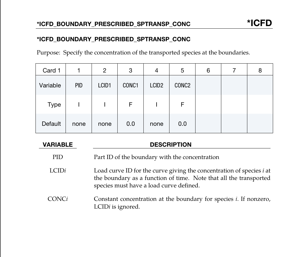

      I encountered a possible inconsistency when setting the concentration boundary condition for species transport in LS-DYNA.
      The keyword *ICFD_BOUNDARY_PRESCRIBED_SPTRANSP_CONC appears differently in the LS-PrePost keyword interface and in the LS-DYNA manual.

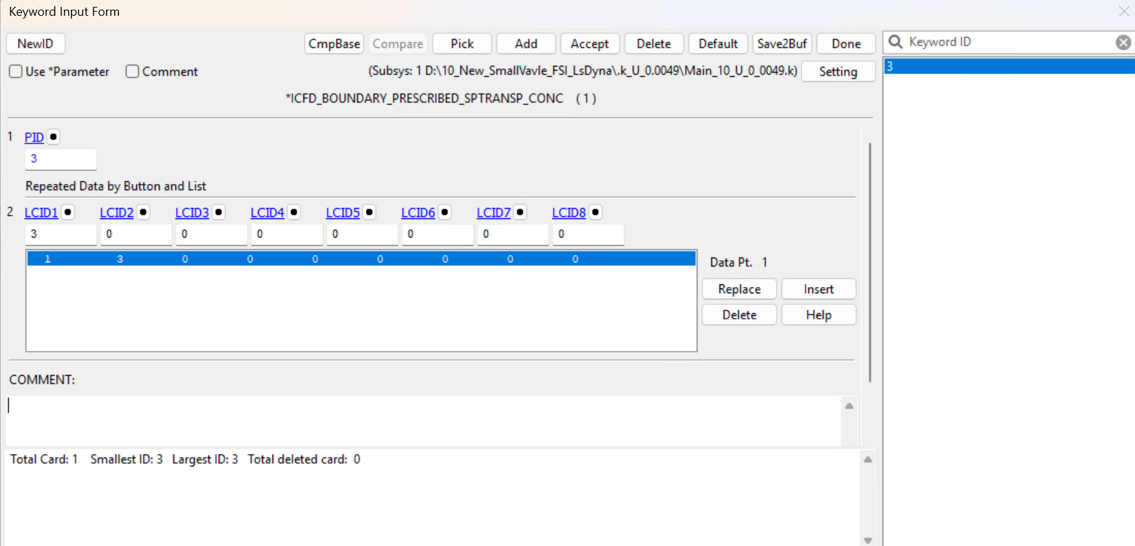

      In LS-PrePost, the keyword is shown as a two-line structure:
      • the first line defines the PID
      • the second line contains the LCID values
      However, in the LS-DYNA manual, the keyword is documented in a single-line format where PID, LCID and CONC fields appear together.

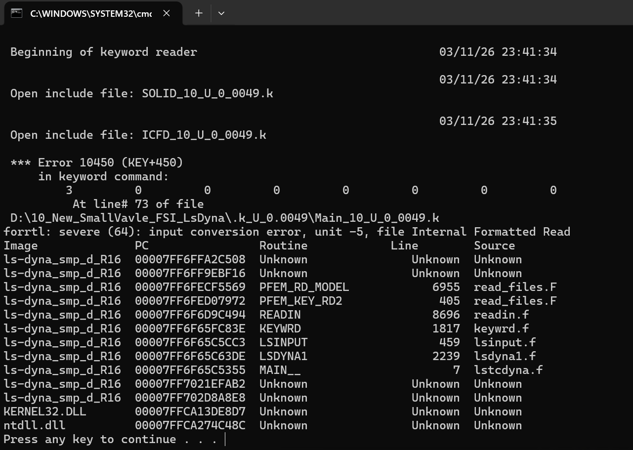

      1. If I follow the format shown in LS-PrePost, the solver produces an error:
      input conversion error
      forrtl: severe (64)
      and the simulation cannot start.

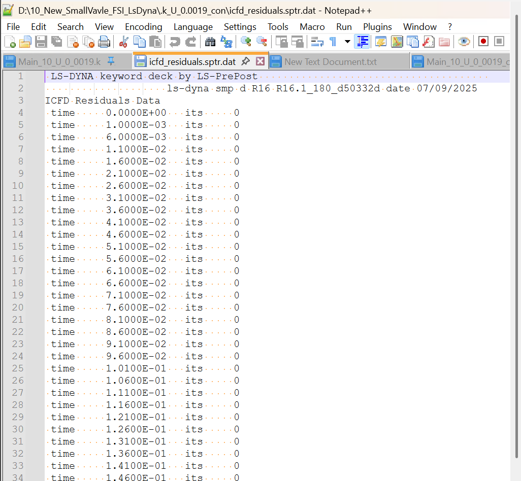

      1. Even if I instead follow the manual format and remove the second line, the simulation runs but the concentration boundary condition does not seem to be applied. In this case:
      • the inlet concentration remains zero
      • residuals for the scalar transport equation are not computed

      Hi
      in general use the way the keyword manual says (and that runs as you saw), not LSPP as that is not always updated with new keywords (manual is of course)
      so say e.g., for PID=1 and LCID=5 (R16):
      *icfd_boundary_prescribed_sptransp_conc
      1,5,
      (use comma here easier to use than spaces)

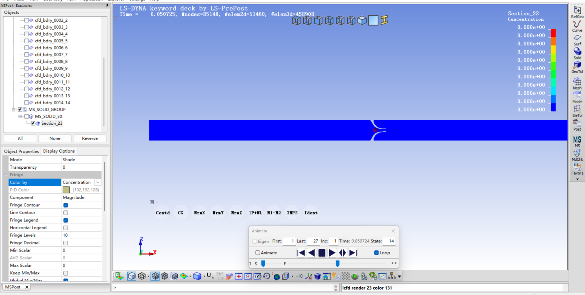

      However, the concentration contour is still completely zero.

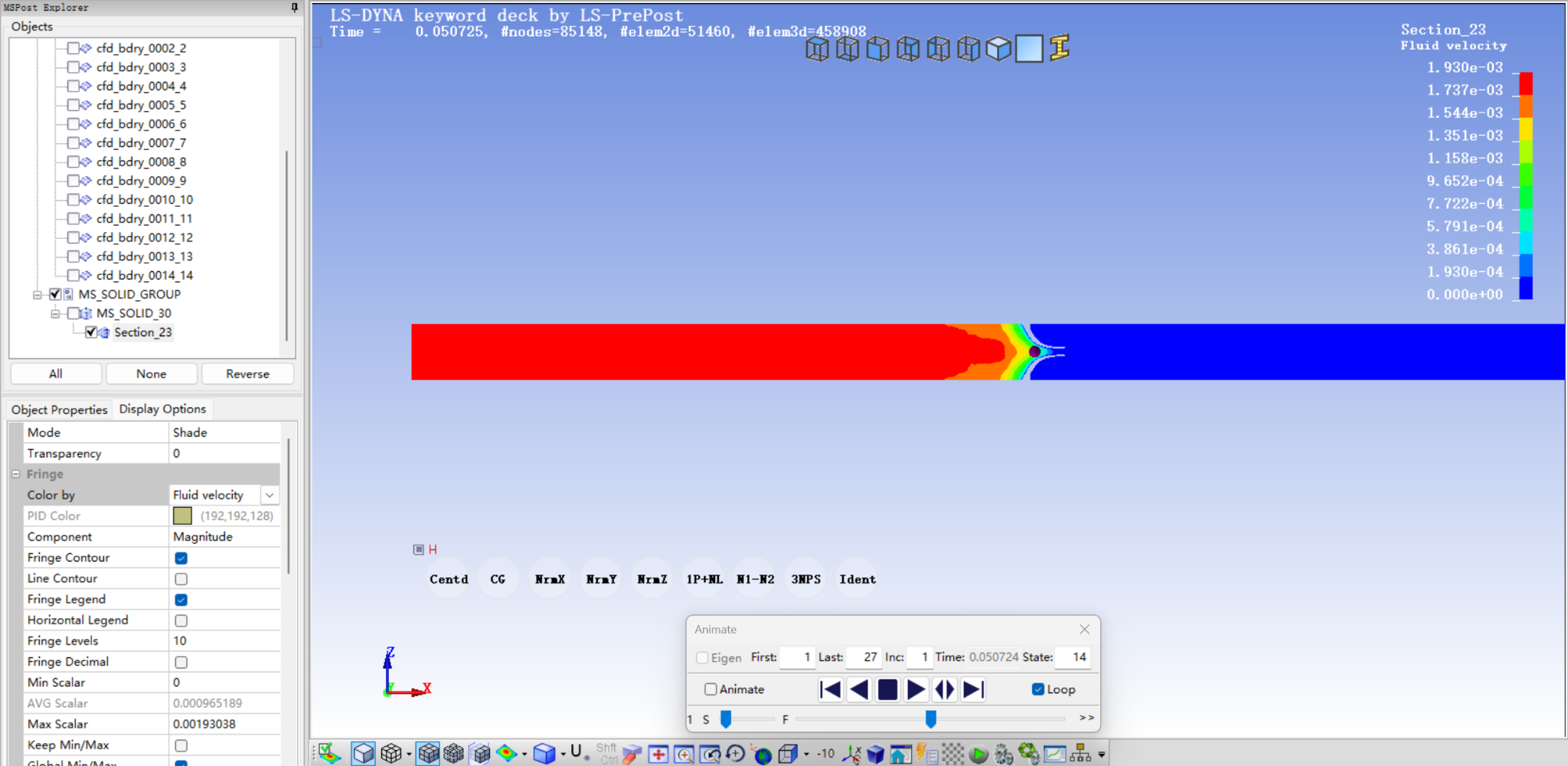

      In the result, I checked the cross-section at around t = 0.0507 s. The velocity field is clearly non-zero, so the fluid is moving. However, the concentration field remains zero everywhere and they used the same ICFD part id.
      So it seems that the flow field is solved correctly, but the prescribed species concentration is not applied to the boundary.
