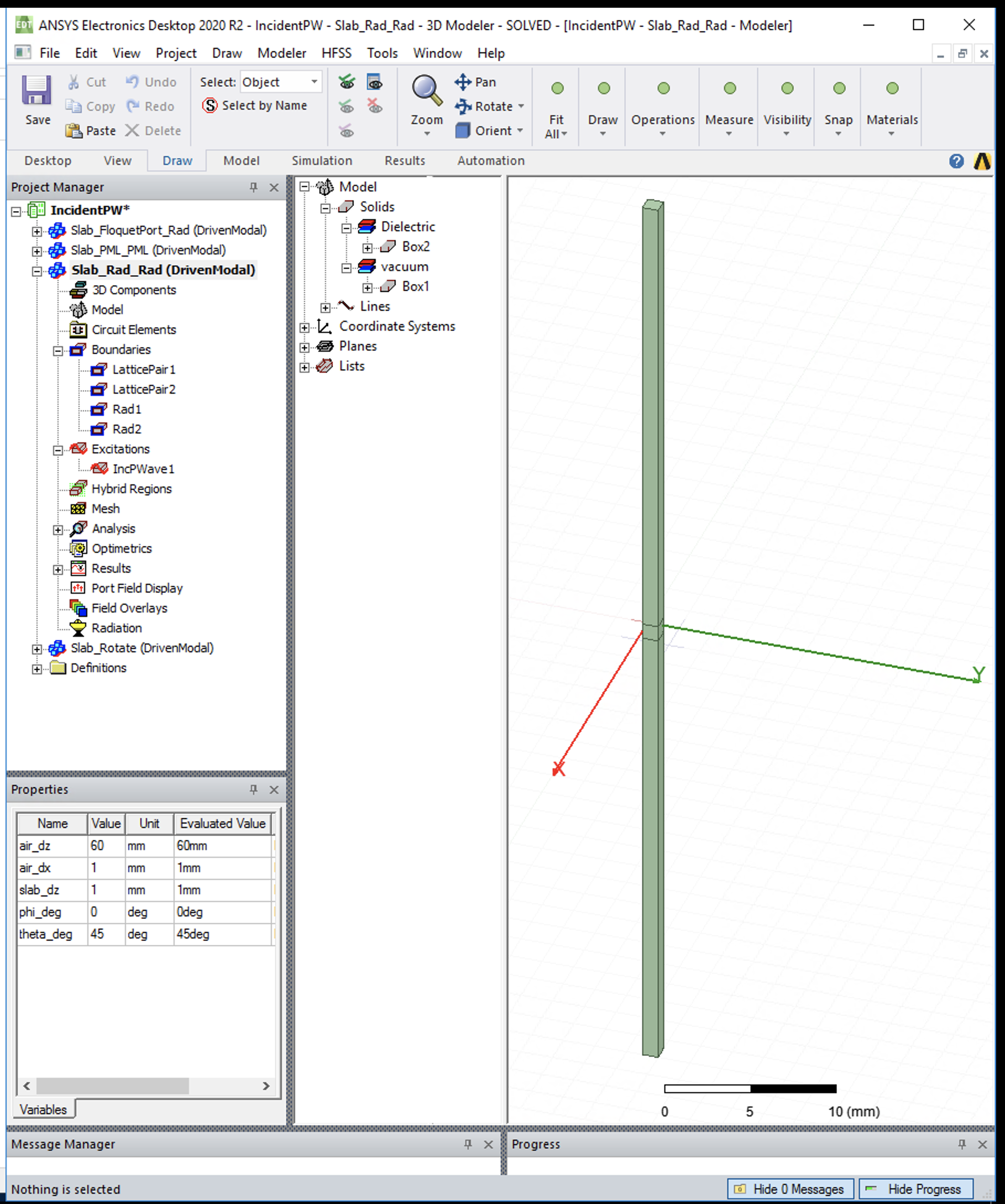

      I am trying to simulate an infinite periodic metasurface, using an incident plane wave and LatticePairs, with the wave incident at some oblique angle. This wasn't working and I have simplified the problem to scattering from an infinite dielectric slab (see attached image).
      I am aware that this is possible with FloquetPorts, but I would like to use an incident wave to reduce computational cost. I have tried terminating the structure with radiation boundaries and PMLs (where the FloquetPorts would otherwise be). However, it seems that there is not a pure travelling wave on the transmission side (ComplexMag_E is a partial standing wave as in the second attached image).
      This makes me wonder: do LatticePairs work with a periodic incident field?

      nThank you for reaching out. I attached a screenshot in my post along with the HFSS file, but here are some more screenshots.nCheers,nVillen
