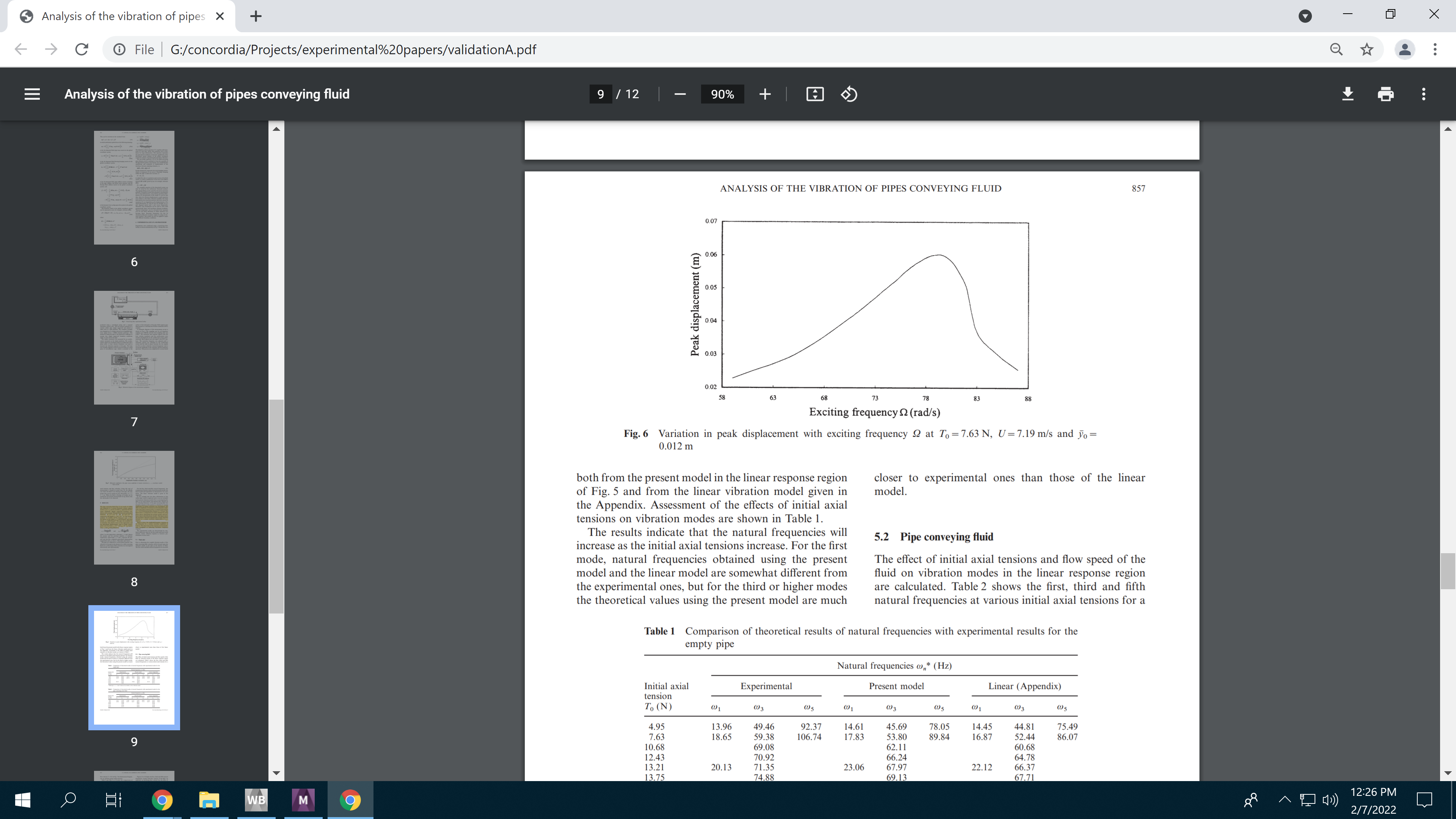

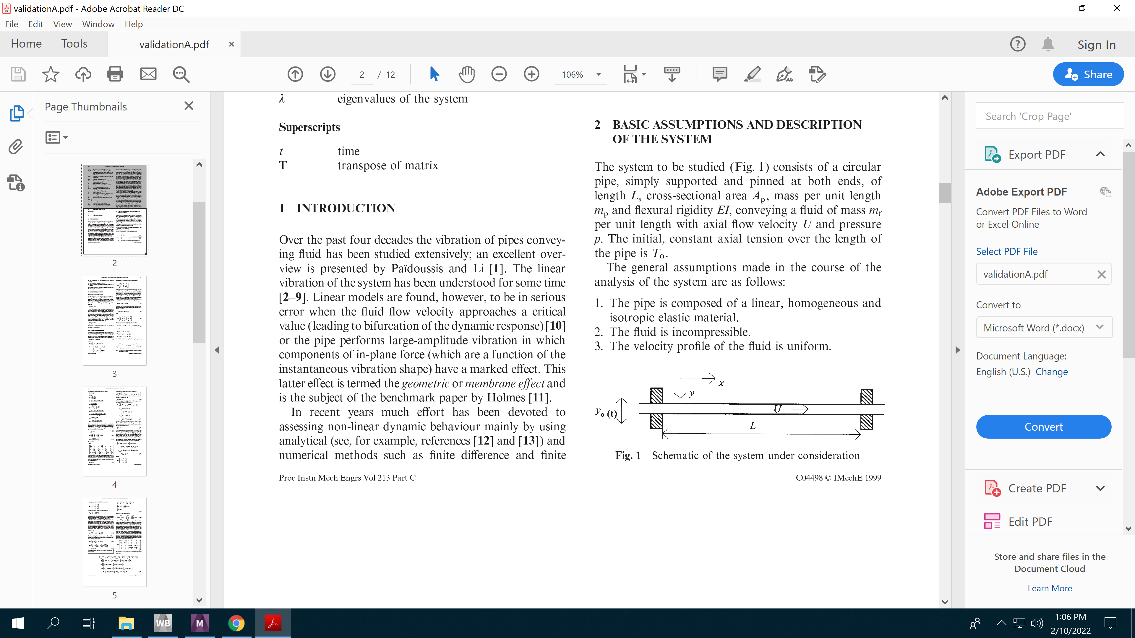

      I'm trying to get amplitude-frequency plot of a pipe conveying fluid. Couldn't you open the screenshots aswell? Because 3 last files are images.

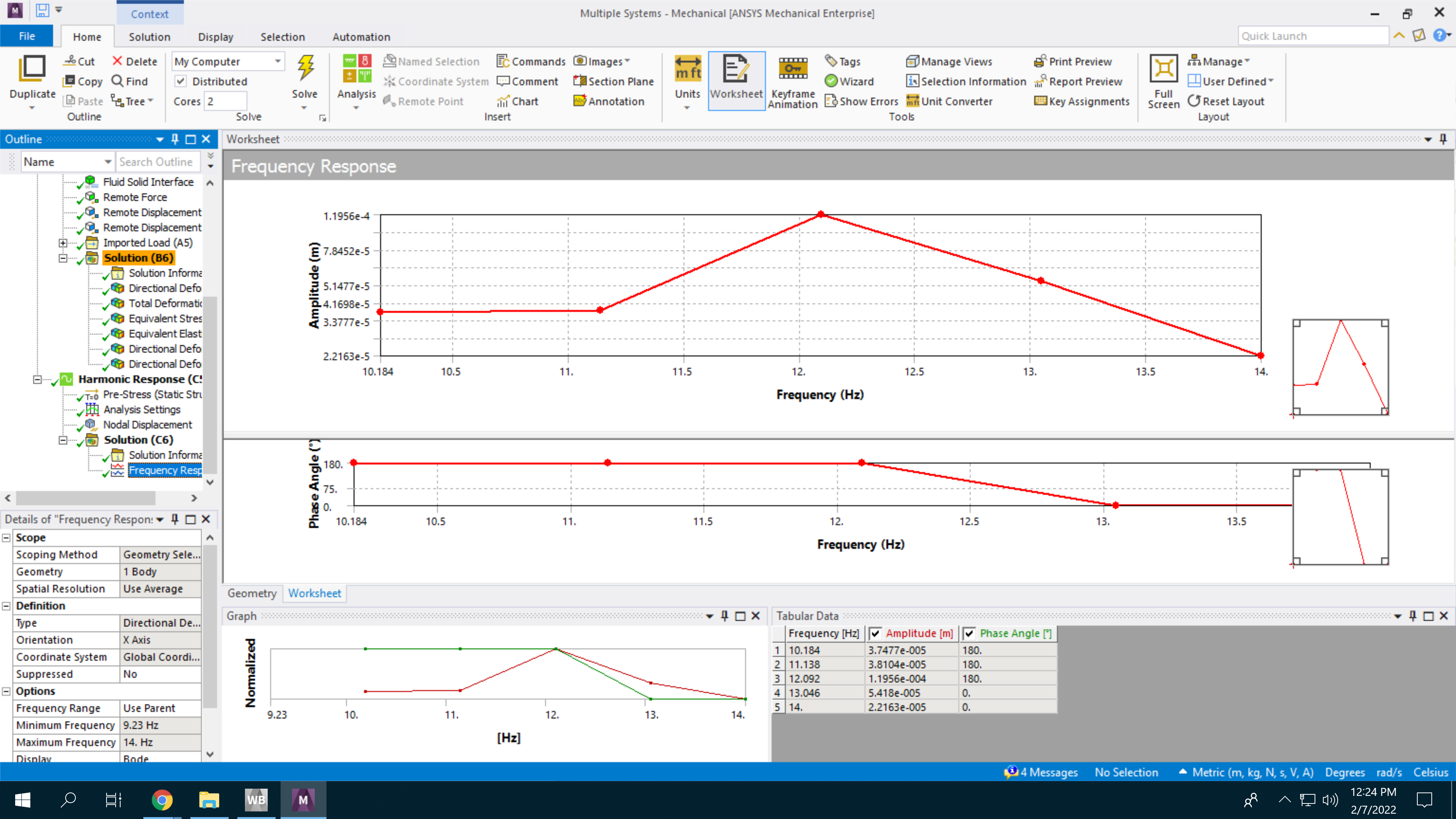

      These are the images one of them is problem description, one of them is the paper result and one of them is my result. Please accept my apologies for sending the files.

    • erik.kostson
      No we can not use acoustics as we said since there are nonlinear effects here so we have nonlinearities due to large amplitudes of vibration here. In the response shown in the second image above labelled Fig.6 one can see probably such nonlinear effect being present.
      So:
      Linear vibrations for fluid conveying pipes (small amplitude vibrations) -> vibroacoustics + BF,ALL,VMEN command
      Can not be used here!
      so you need to:
      Nonlinear vibration effects on fluid conveying pipe (say high amplitudes) -> the only option that might be able to capture this is a 2 way FSI (E.g., Fluent+Transient Structural Mechanical (with large deflections))
      SO a full 2 way FSI analysis as shown here:
