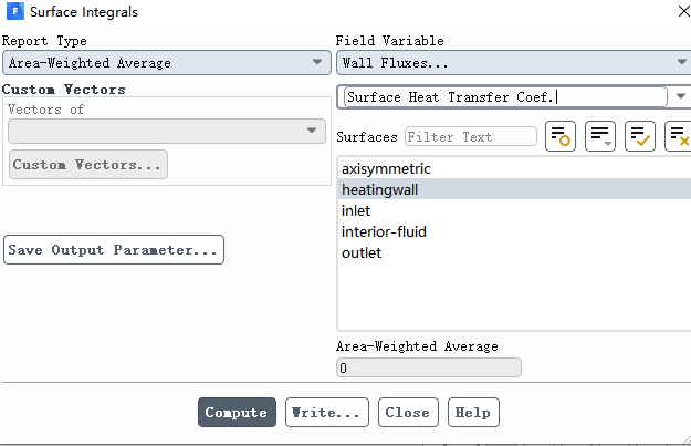

      How are you calculating HTC?
    • csZY
      I  calculate HTC by  averaging the HTC of heated wall by integrating it like above.
      OK, so unless the DPM model is having a significant effect on the system flow HTC to the wall will be fairly independent of particle size.
