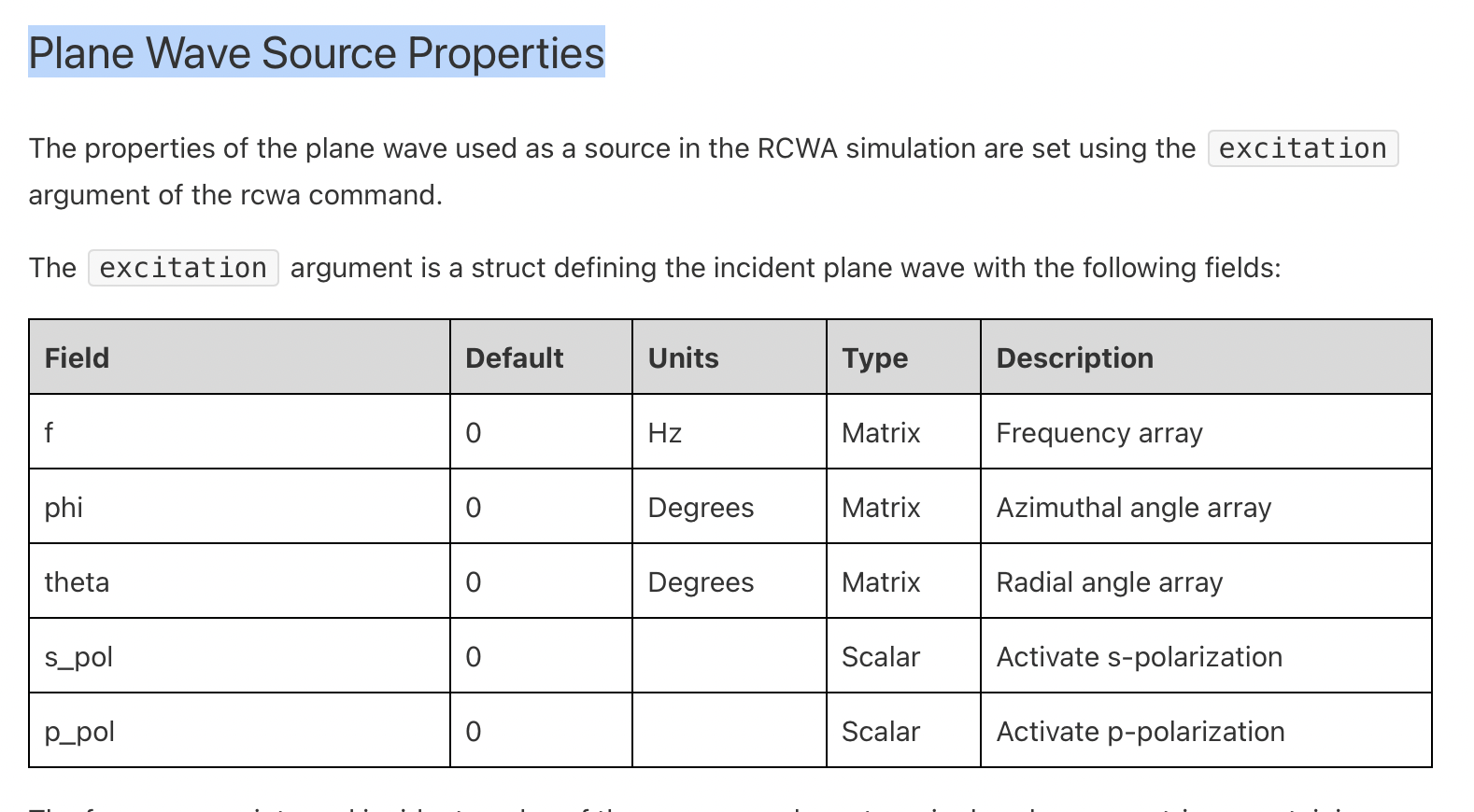

SubscriberHi everyone, I'm trying to understand the RCWA code but in the properties it doesn't permit to change the polarization, for example I want to send Circular polarization in that case I wanted to put: excitation.polarization = 45° but It is not a parameter, there is a posible to excite my structure in other way with circular pol.?
February 18, 2022 at 11:43 pmGuilin Sun
Ansys EmployeeThank you for your interest on the newly added solver RCWA.
Currently it seems it only allows one polatization, either p or s, but not circular or elliptical polarization. and the current results are intensity/power quantities:
Since this is a field solver, I believe that it can output field quantities, such as the complex Fresnel coefficients r,r',t and t'. However this will be a new feature. Could you please file a new feature request here? Vote new features, and file your feature request thank you!
