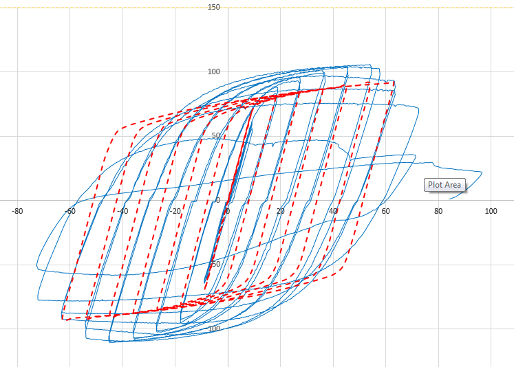

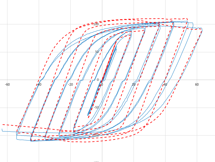

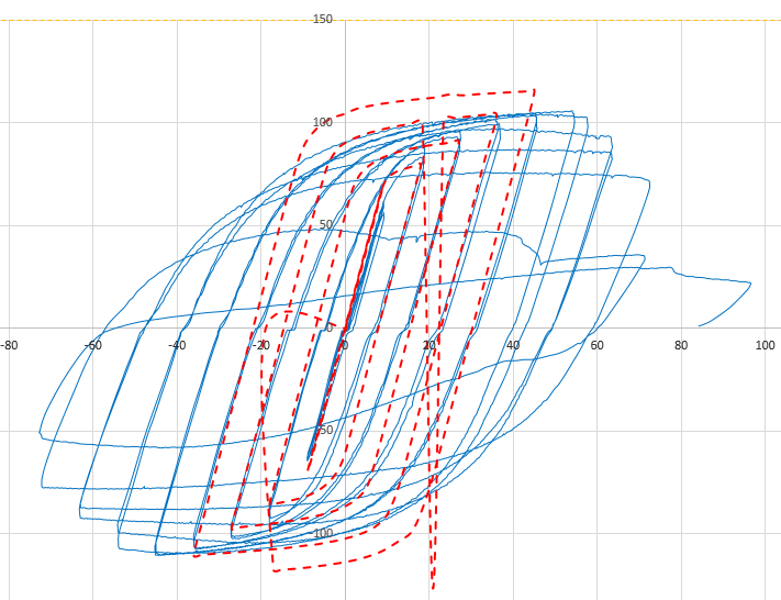

SubscriberDear bsista,nI appreciate that you spending your precious time with me here. The firs of all, I would like to provide a brief information about what I do here. nI am simulating a cantilever beam under cyclic loading. But there is many questions are arising here. For example,nhow to plot Load-Displacement hysteresis loop from results?nYour right I want to result Bauschinger effect but it is not shown why? How can I plot such kind of nice loop as shown below? n I tried 4 different plastic material in my simulation. Here i want to show you one by one. nWhen I use multi linear isotropic hardening material with true stress, the simulation is terminated after several load step. How can I continue without error?n
When I use multi linear kinematic hardening material with true stress, the simulation was successfully done. But result was not what I am looking for.n
When I use Bilinear isotropic hardening material with 1025 MP tangent modulus , I could find relatively good loop compare with others. But there is Bauschinger effects was not match with experiment results. Dashed line indicates simulation here. n

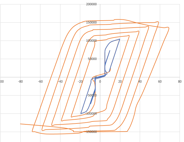

BKH i did not try to do here.nI have questions:nIn order to plot load-displacement curve in this cantilever beam, I used the command a probe-deformation-Y direction selection. Then I did Equivalent von mises with this directional deformation correlation as show above figures. Is it correct or not please tell me. I did not understand that NLEPEQÂ command to use here. Could you please give me little explanation about that? what reason can I use that?nTo fix that strange knees in the loops, should I use chaboche kinematic hardening material? If I do not have chaboche material test results which needed to get parameters, can I simulate material test under cyclic loading in ansys approximately? In this cas how can I do this test simulation?nI really appreciate that you giving any time to answer my crazy questions. Sorry I am a really fresh in the ansys and plasticity of material. Thank you thank you.nBest regards,nUNUR from Japan.
