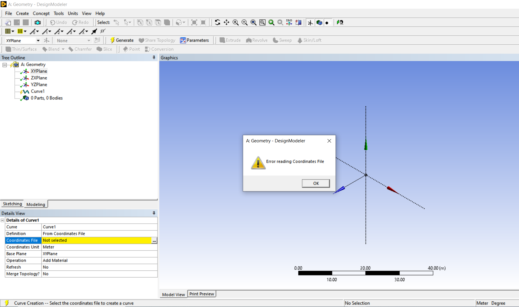

      • Aras karimi
        Then I tried to open this file in Design Modeler software, but I encountered the following message:

    • Nanda
      Hi Aras,
      As mentioned in my initial response, you have to generate points first, and then the second step would be generating 3D curve from points.

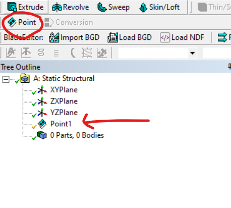

      • Aras karimi
        I imported the points first, but it only shows me the points of the bottom surface of the geometry, and also the yellow mark is visible in the tree diagram and at the bottom of the left page.
