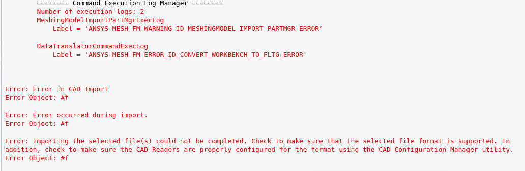

      I created my geometry in DesignModeler in the Ansys Workbench. Because I want to speed up the simulation, I run my simulations on an external super computer. When I open my geometry in the 'Meshing' mode on the super computer, I got this error:
      It's strange because the geometry opened on my pc also has the .agdb extension. Does anyone know how to fix this?

      are both systems using the same version of Ansys software?
    • Edward Vermeersch
      The external computer has Ansys Fluent 2023R1 and I use Ansys Fluent 2023R2.
      • Federico
        Unfortunately, Ansys releases are not backward compatible: a geometry created in 23R2 could not be read in 23R1. If you have access to 23R1 in your local machine, I suggest you use it for projects to be run on your HPC.
