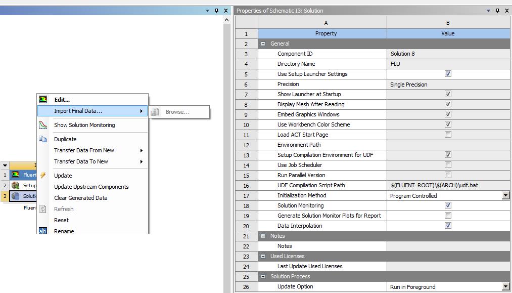

SubscriberHi all,
I am trying to import final data from a cluster into Fluent. I have read that is possible to import as final results and the thick green is activated which means that I can use to keep working and manipulating the data; however, the browse button is disabled. If somebody knows if I need to activate something else, or do another step, that would be great.
Thanks,
Paul
September 25, 2018 at 6:04 am
Keyur Kanade
Ansys EmployeeInstead of Analysis System, please use Component System. Please use Fluent in Component System and check if it is available.Â
Keyur
September 25, 2018 at 2:31 pm
September 25, 2018 at 2:52 pm
Keyur Kanade
Ansys EmployeePlease right click on set up.Â
