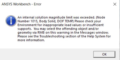

      Please i am importing external data in the format that's accepted by the ANSYS Workbench (.csv), defining each column and then link this External data with required module.
      Note that:
      -- The imported file (.csv) includes data that are not previously generated from ANSYS
      --> I selected the type of imported data to be: (Heat Generation)
      But when i started to solve i got the following error, & don't understand what's the problem???
      Any HELP about this is highly appreciated...
      Check that the Units used for the analysis match the units used for the External Data.
      For example, if the External data is in SI units but you set Mechanical to mm, that would cause a problem.
    • Samar
      Both are in mm unit..
