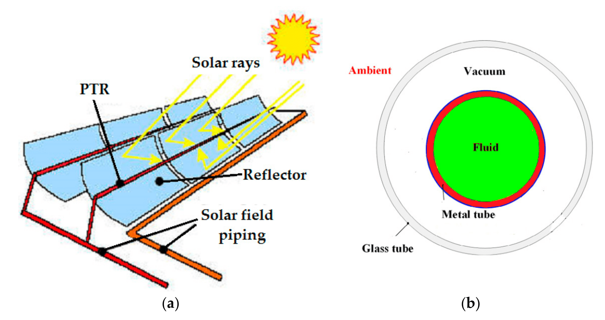

      I am currently working on a project that involves coupling ANSYS Speos optical simulations with ANSYS Fluent thermal analysis. My goal is to import the heat flux data generated in Speos directly into Fluent for a conjugate heat transfer study.

        In my application, which involves a solar parabolic trough, the heat flux from the optical simulation will transfer through the wall thickness to the water fluid inside the tube. Therefore, the heat is applied to a wet wall adjacent to the fluid domain, and my goal is to perform a coupled thermal-fluid calculation to capture the conjugate heat transfer.

      So, you're getting Speos data at the outside of the metal tube? We can then include the metal as a solid or use a thin wall. Either way, Fluent wants data in a "Profile" format, with position and either heat flux or temperature. Heat and flow are coupled in Fluent (it's a normal application) my question related to whether the Speos>Fluent data transfer was a one off or if you need to feed data back to Speos.

      Yes, the Speos data corresponds to the outside surface of the metal tube, and I plan to include the metal wall in Fluent for the conjugate heat transfer analysis. This will be a one-way transfer only, and I do not need to feed any data back into Speos.
