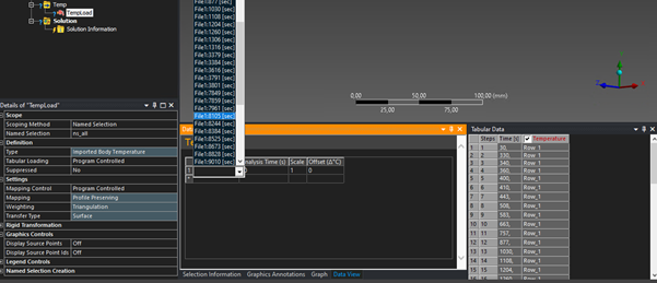

      I have csv files that have displacement and temperature data for multiple timesteps for the model on which I am running the simulation. I have so far been able to implement displacements and velocities in every timestep without the need to use “Imported Load” since these boundary conditions only apply to certain edges/bodies. However, my temperature data consists of x and y coordinates (2-D Geometry) and the temperature at that point for every timestep. Doing this while utilizing GUI, I am easily able to utilize  “Imported Load”  to set each column to a timestep and everything is imported without issue. However, with scripting, I get stuck at filling up the table to assign timesteps to specific rows:
      The ”Recording” feature has unfortunately not been of much help, as when I assign a column of my imported data to an analysis time to fill up the table, no code is being recorded, which leads me to believe that this task is not automatable.
