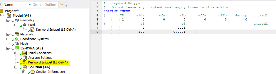

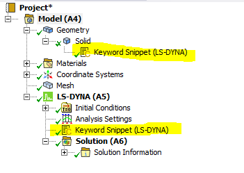

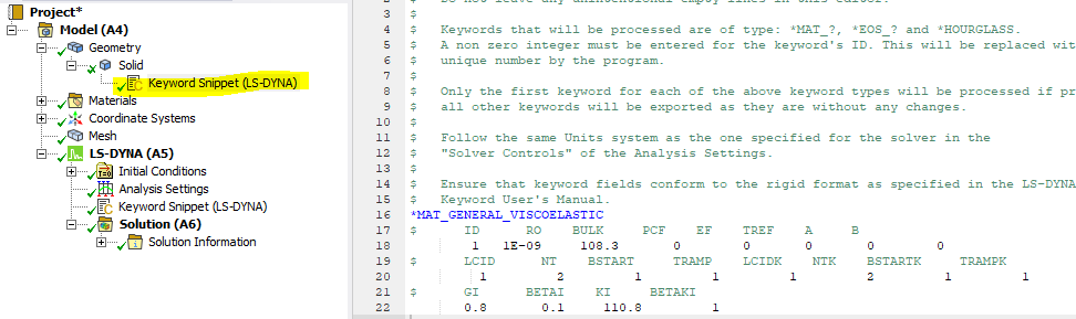

Ansys EmployeeIf the strain rate-dependent of piecewise linear plasticity (MAT24) is defined through the Strain Rate Parameters c & p, the Mechanical GUI will take the definition from Engineering Data.
However, if the strain rate-dependence is defined as multiple stress-strain curves, you need to use Keyword Snippet in Mechanical GUI. The Snippet is inserted under the body in Geometry to replace the default material assigned to the body. In the keyword snippet, you need to enter the material data in exactly the same format as defined by LS-DYNA Keyword Manual. See attached pictures below.
Two keyword Snippets are inserted into the Tree Outline:
The 1st Snippet defines the material keyword:
The 2nd Snippet defines the curves used in the material keyword. The 2nd snippet is required since the 1st snippet only accepts the keywords beginning with *MAT, *EOS, and *Hourglass.
LS-DYNA Keyword Manual is now part of ANSYS Installation and can be accessed from Windows Start menu.

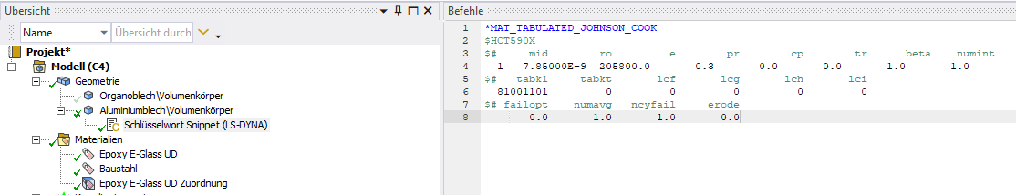

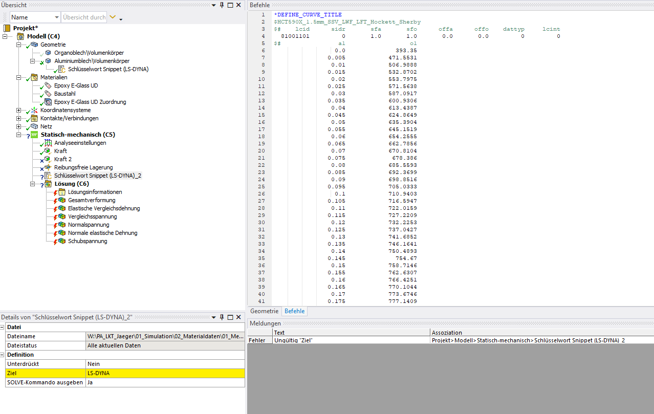

SubscriberHello everyone,
I tried to insert the material data (MAT224) exactly as in the description. But in my case I directly get a question mark and and error message.
When I try to insert the curve like the *MAT within the geometry, the job starts. But the Keyword Snippet and so the curve is not considered. The solutions are the same as without the Snippet.
Do I have to consider some additional settings?
Thanks in advance!
