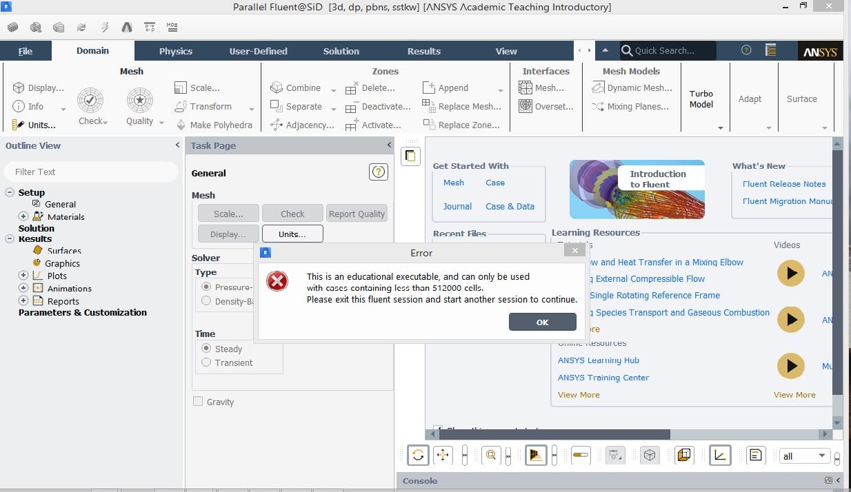

      After completing meshing of the geometry, I am facing following problem in Setup Launcher.
      Please help
      Thanks
      Siddharth
    • Keyur Kanade
      with student version the limit of no. of cells is 512K.
      you need to mesh your model so that you have max 512K cells.
      Keyur
