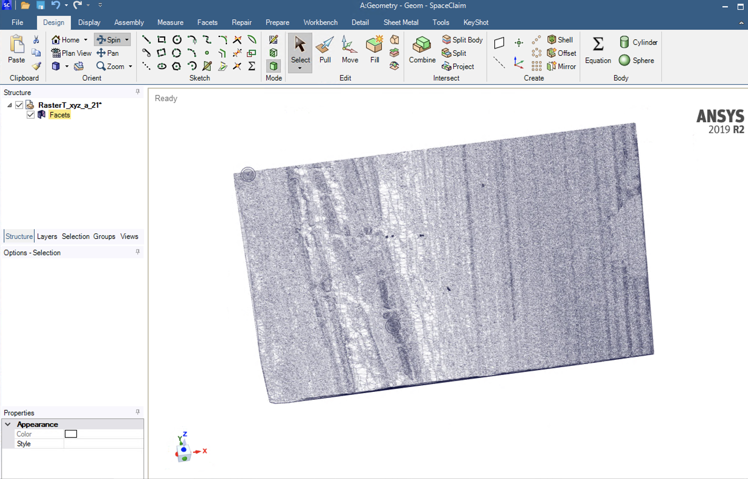

      I have imported a STL that appears to have some sort of mesh to it (see image) but it Is still flat in the vertical direction. Is there a way to change this once in SpaceClaim or does this have to do with the import itself being corrupted?
      Thanks,
      Alex
