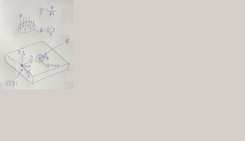

I'm trying to implement a moving pressure load with a circle shaped area, which is moving along the Y direction via do loop.
The pressure value is uniform and located within a circle shaped area.
The moving direction is the Y axis. It should start at the global CS (0,0,0) and heads towards the positive Y axis.
The load isn't moving, I don't have a clue why.
The script is posted below due to size restrictions in the post.
Best regards,
HF

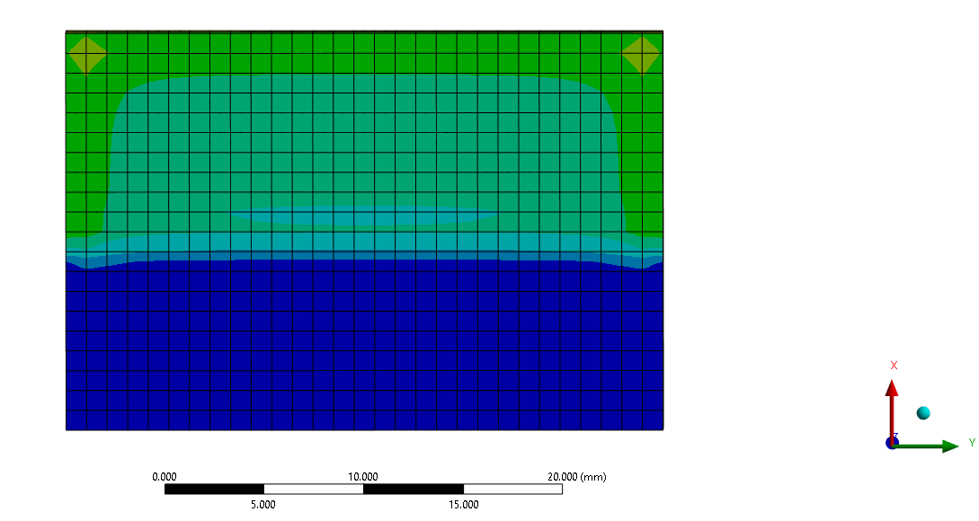

BenjaminStarling
SubscriberHi Holly,
I created a mock shell model with a fixed support around the edges.
Please see attached images highlighting the following things.
- Considering you are in the workbench environment you do not need a do loop to acheive this (it may not have been required in MAPDL either)
- I have created a cylindrical CS in workbench which I have identified as CS12. I then move/redefine CS12 based on itself. No need to move the WPCS around and create more CS.
- Your intialising scripts to create the surface elements and define parameters should run at the first load step. The moving of the CS and applying the pressure needs to occur at each loadstep
- You should not be using substeps in this analysis. During a substep you cannot move the CSYS/Pressure load. Only use substeps if they are required for ramping the load/convergance issues. Even in that instance you may not get the desired effect of the rolling pressure.
- I have set up my analysis with an increment of 5mm across a 100mm plate, going from 25mm to 75mm across the width of a plate. I have input these numbers directly but these can all be parameterised. I moved the CSYS back from where I would like it to start such that the first load step moved it to the desired location.
If any of the features I have relied upon are not available in your academic version please let me know and I will find a work around. I am working on 2019 R3.
