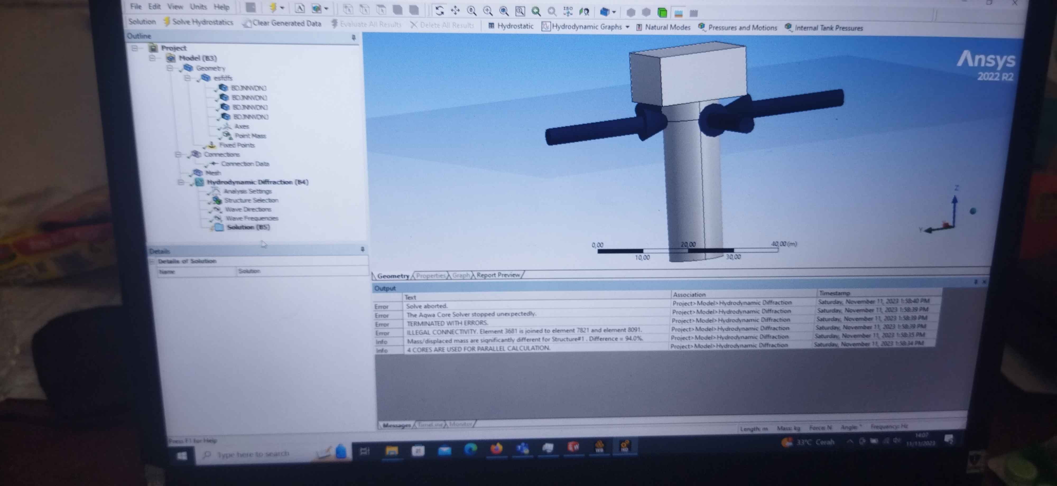

November 11, 2023 at 7:09 am
muhammadagussriharto
Subscriber -
November 13, 2023 at 2:48 pm
Shuangxing Du
Ansys EmployeeAqwa only requires the external hull surfaces to generate meshes for the hydrodynamic diffraction analysis. Having the connectivity problem is mostly caused by the compments inside the hull were modelled.
You can use Ags to visualize the Aqwa panels. Some operations described in Aqwa Graphical Supervisor Users's Manual, Section 11.3 Selecting QPPL& TPPL Elements may help.
