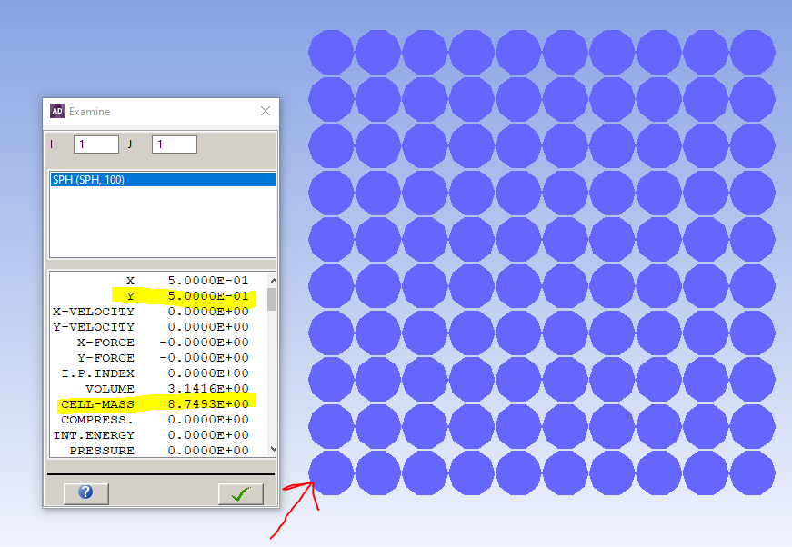

Here are my calculations:
For the SPH particle at the bottom left corner: X = 0.5 mm, Y = 0.5 mm, Particle Size = 1 mm, AL2024-T4
Cell Mass = Density * R^2 * 2 * pi * Y = 2.785 mg/mm^3 * 1 mm^2 * 2 * pi* 0.5 mm = 8.7493 mg. See attached picture below.

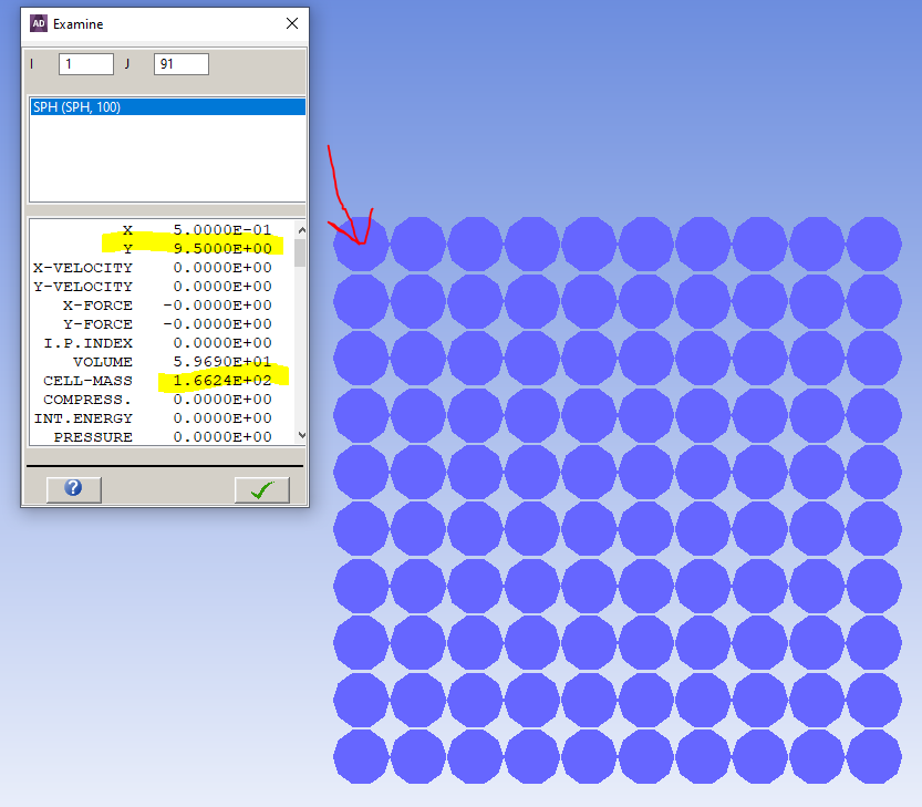

For the SPH particle at the top left corner: X = 0.5 mm, Y = 9.5 mm, Particle Size = 1 mm, AL2024-T4
Cell Mass = Density * R^2 * 2 * pi * Y = 2.785 mg/mm^3 * 1 mm^2 * 2 * pi * 9.5 mm =1.6624E2 mg. See attached picture below.
