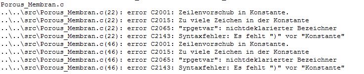

      I´m trying to write an UDF for porous media which depends on time. So I have used an If-Statement, but an error occurs.
      Is it necessary to have an else-statement after if? If yes, what should I write for the else? that the "source" is zero?

      You need to put the if statement inside the the DEFINE... macros.
    • Max4
      Before defining the variables? Then I have to do one for each macro, I guess. I have tried this, but it doesn´t work.
      Maxime
    • DrAmine
      First of all that would not work using (rpgetvar..) that is now C and not Scheme. You need to use the macros CURRENT_TIME or RP_Get_Real("flow-time").
