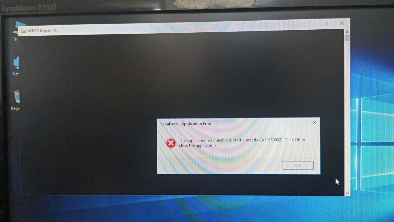

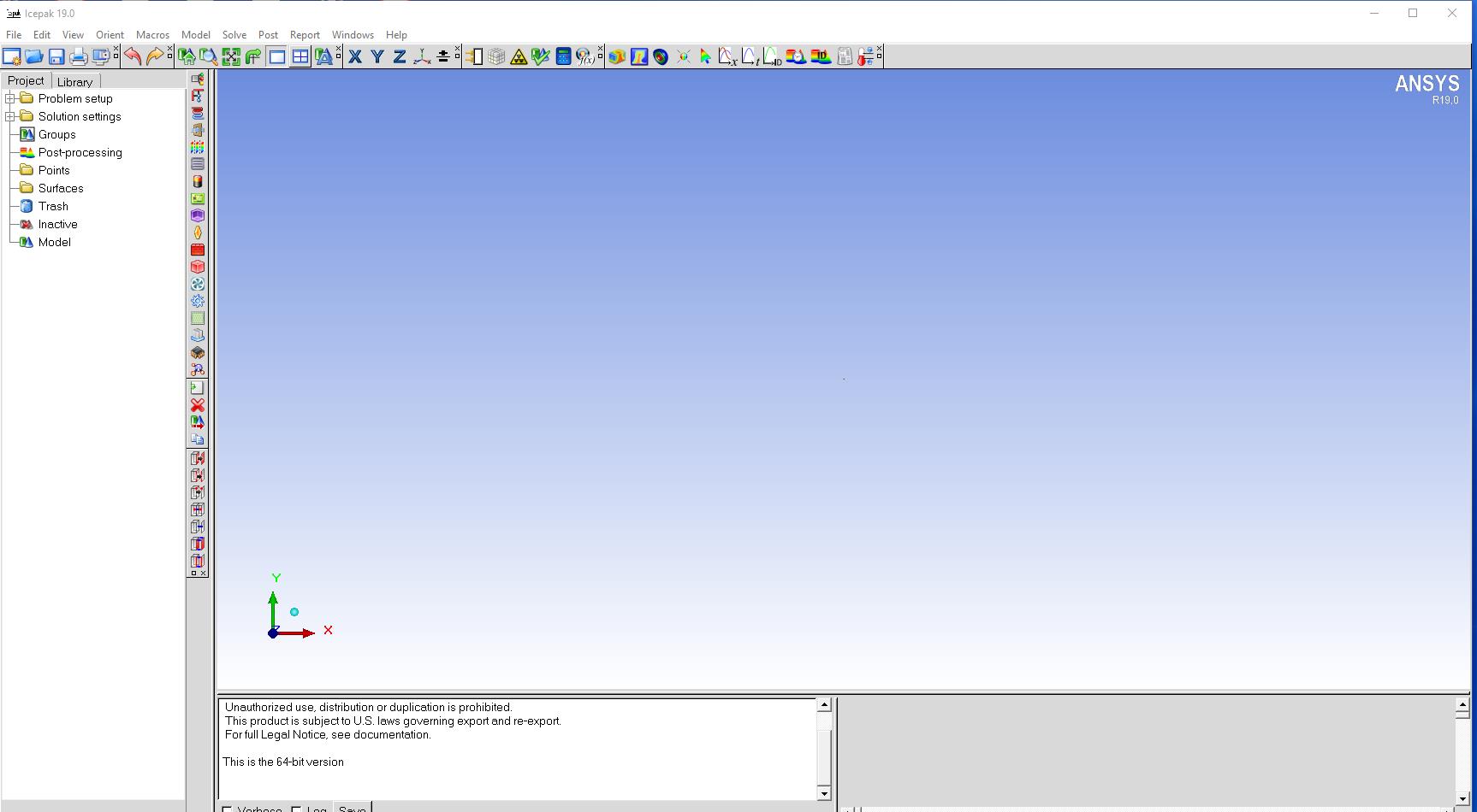

      I seem to be having issues running Icepak on my computer. I have an ANSYS CFD Research License installed, however when I open up Icepak, I am not able to click on any of the options. Neither does it show the default window of 'Open Existing', 'Unpack'. Right now, it's basically a blank Icepak window with the toolbar grayed out. When I open up Icepak through Workbench, it works fine allowing me to run the simulations as expected. So basically Icepak does not work when I open it up through the Start Menu. ANSYS Spaceclaim on the other hand is working fine. I have attached a screenshot of the blank Icepak image.
      Could someone tell me what the issue maybe?
      Thanks
      Nithin

      I tried setting the environment variable as you suggested-it did not work. With regards to the display, this should not be the issue since I have used ANSYS on the same computer with a previous license without any issue. Right now, Icepak opens up but the toolbar is greyed out and it does not allow me to select any of the options. Closing the window too isn't allowed and I'm forced to shut it down by opening up task manager and ending the task. It works fine when I open Icepak through Workbench. Anything else I can try?

      Are you running dual monitors? Is your primary monitor the right monitor? If you are, try this out, I've seen something like this before. Change your primary monitor to the left one.
      Right click the desktop, screen resolution, click on the left monitor, make primary. Might differ depending on your OS, I am on Windows 7.
      If this doesn't apply, disregard.
    • upot2
      Hi Dyakinian,
      Thanks a lot! Changing the main display worked.
    • David Yakinian
      This is a very specific bug, it looks like there is no issue with 19.1.
