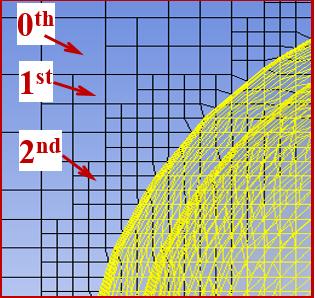

      Multi Level options helps to capture objects of different scales with reduced mesh count using hanging node mesh option. Attach image.
      MultiLevel- Value 2 Zoom in view

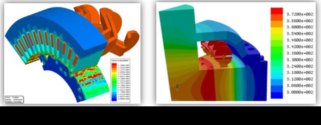

      I am not sure on size on small gap. But if you need good localize mesh control, did you also explore ANSYS/Fluent mesher and Fluent solver for this application. As you may need good localize mesh control.
      Motor_Cooling
