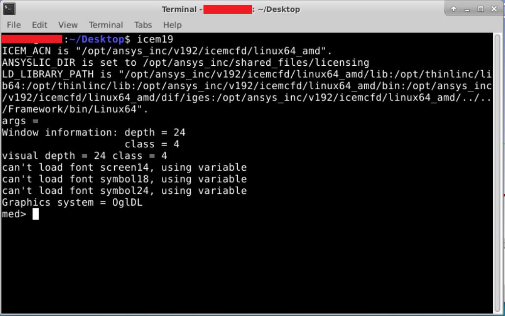

SubscriberHi,
I am new to the Ansys world. I just started to do Fluent simulations with an academic license (Ansys R19.2 Academic). And I work on a linux server, which i access over thinlinc. ICEM 19.2 has strange/unreadable text (see picture in attached file!). The strange thing is that this is only the case in ICEM. The Workbench, Fluent, CFX5 postprocessing look fine. It is just ICEM that is like that.
Does anybody has an idea, what I need to do to fix this?

Looking at the images I suspect it's screen resolution/font libraries so see if you can tweak the image window resolution.Â

SubscriberHi, btw this solved the problem for me:
https://www.cfd-online.com/Forums/ansys-meshing/89147-error-when-starting-icem-cfd-ubuntu.html#post539158
