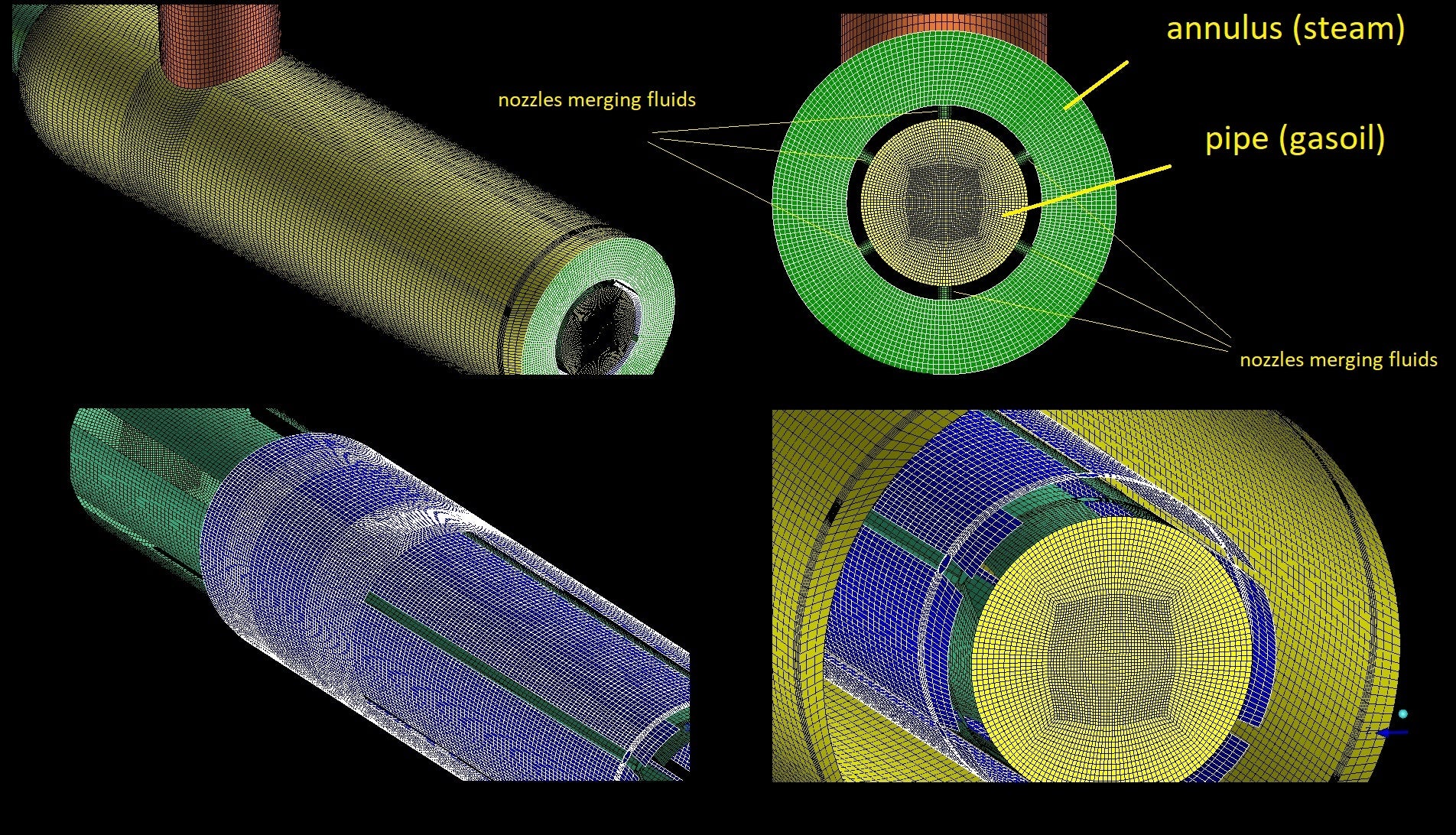

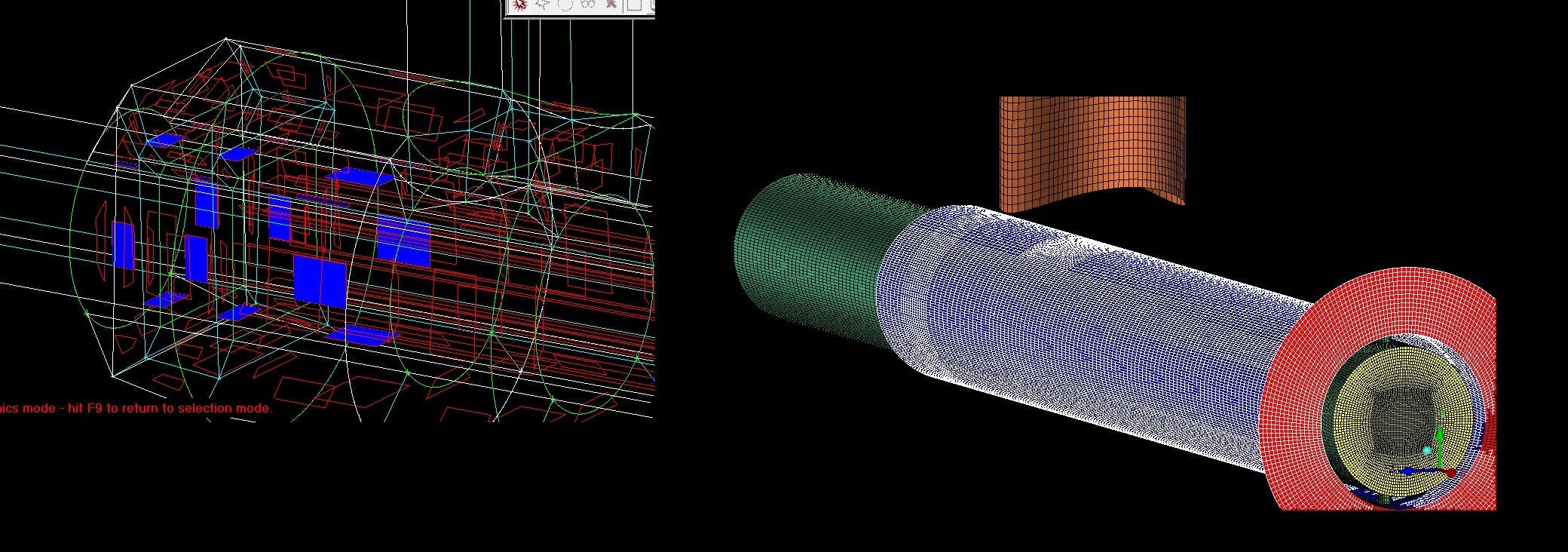

      Can anyone help me to fix this issue? I have these long empty stripes (exactly at the nozzles joining the annulus and the pipe).
      I dont understand why the blocking sticks to all the surface except to these stripes.
      Thank you
    • ai0013
      My fault, I missed to associate these faces. Now its fixed
