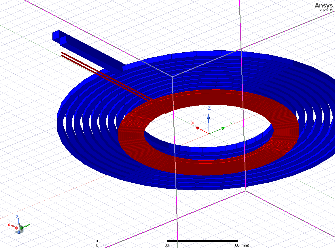

I am doing some wireless power transfer research.
My TX coil on the bottom in red is 2 layers of 25 turns each. My RX coil in blue is 10 turns with one layer. What is the proper way to model and simulate the layers for the TX coil. Also, is there a way to adjust the turn spacing between the coil wires?
August 10, 2023 at 4:32 pm
GLUO
Ansys EmployeeHi,
Not sure if I fully got your question. You could extend the coil end to the solution region boundary and assign excitations on the end. If the coil model is created by Maxwell spiral, you could change the parameters to adjust the turn spacing.
