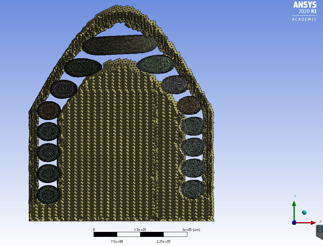

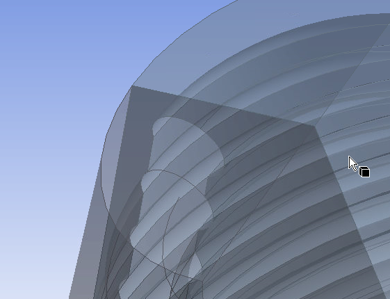

SubscriberI am using a tetrahedron for the cavity. The geometry was chopped-up so I could get better mesh quality so interfaces were used. I have not tried using a conformal mesh. Where can I find the share topology option?nHere is the cross-section of the mesh: Y-Z Orientation:n
Details on Y-Z Orientation:n
Y-X Orientation:n
Details on Y-X:n
I'm not sure how to asses if the mesh density is sufficient for the simulation. I am using a Research license. I cannot access my advisor's costumer number as of now, so I'm asking around at the educational forum.nI will try your suggestion with the energy equations. Than you!n

Ansys EmployeeYou are using patch independent tetrahedron. nHere is video on share topology nPlease see help manual for more details about these commands. nn
