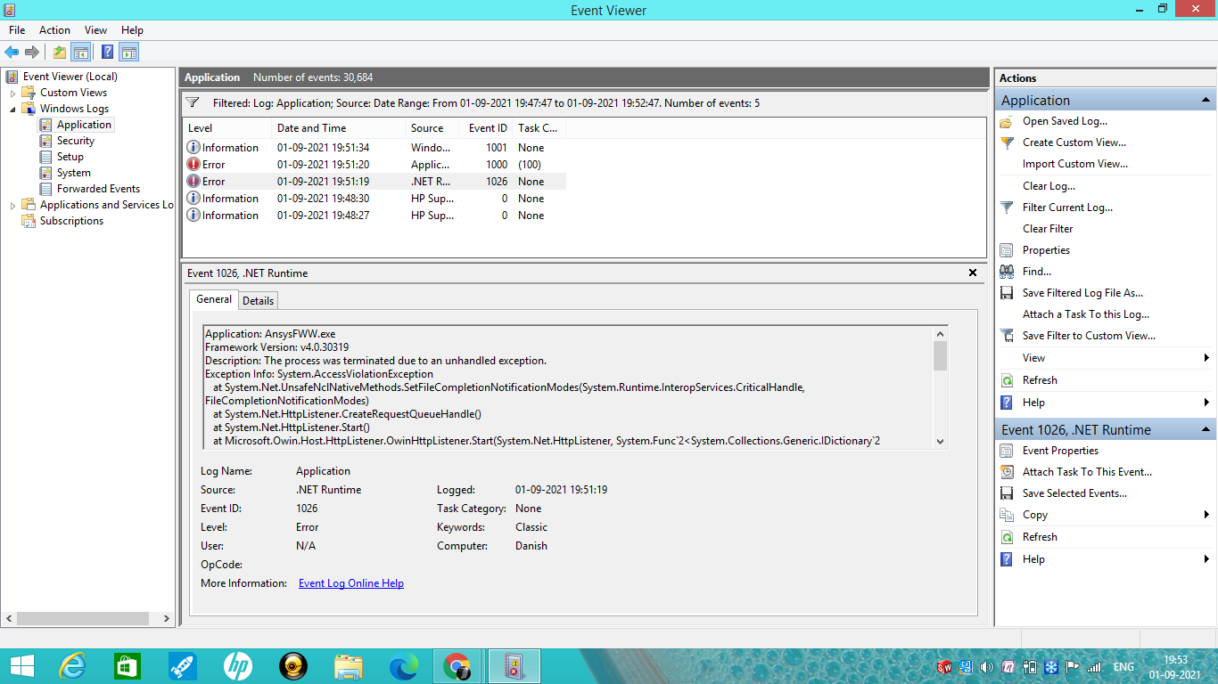

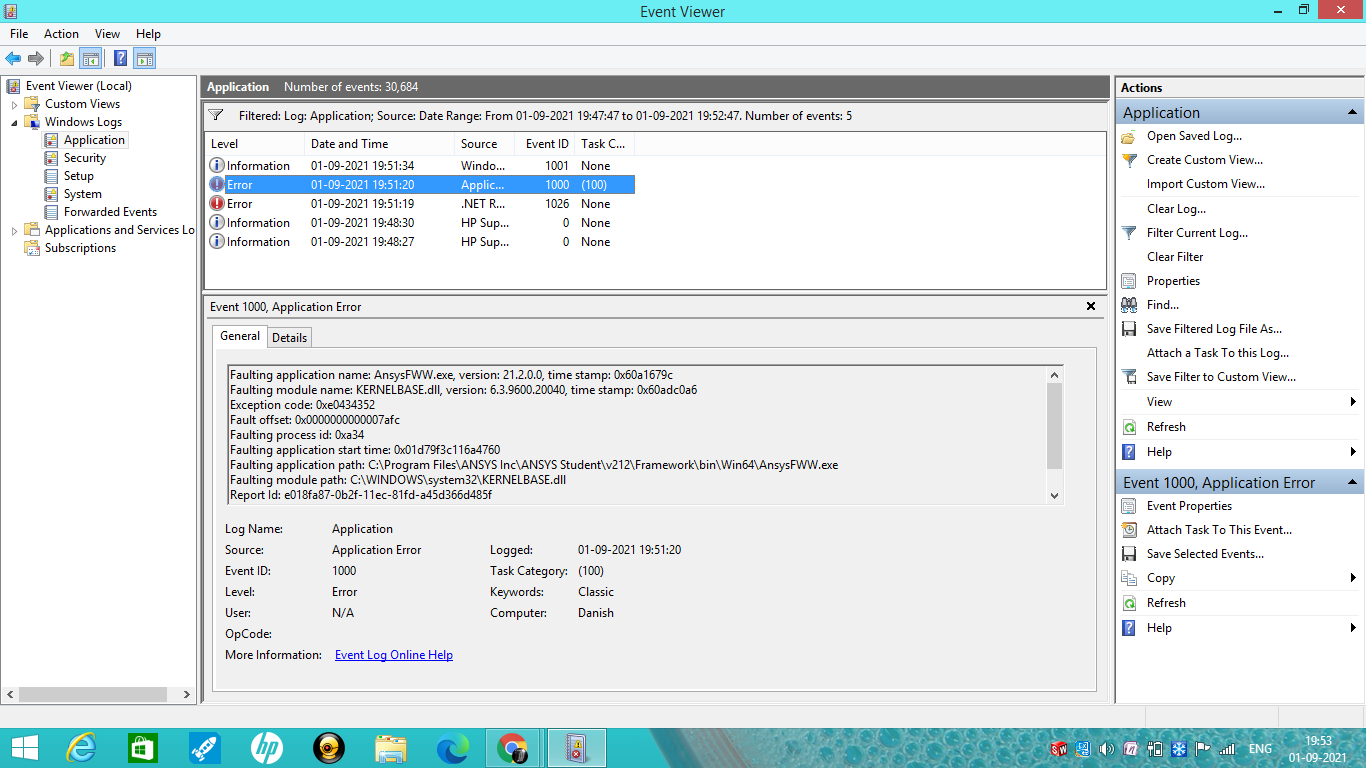

Ansys EmployeeCan you please post the screen shot as we are not permitted to open files.
Also, can you check Windows Event Viewer-> System, Application logs for any errors. post the screen shot of those.
September 1, 2021 at 2:26 pmSeptember 2, 2021 at 12:00 pmdanny_54

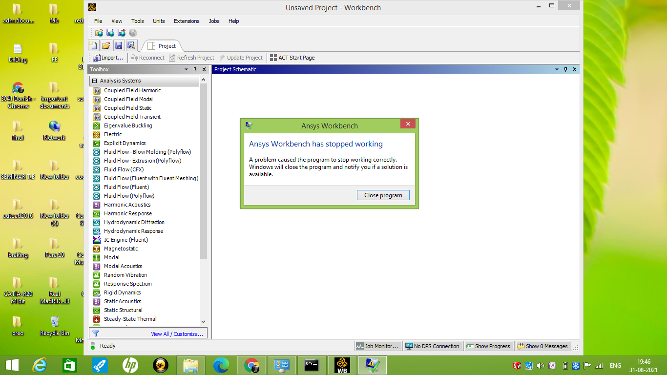

SubscriberPlease Help with the next steps..... I've done what you've asked for
September 8, 2021 at 3:16 pmGeorge Karnos
Ansys EmployeeCan you try starting Workbench by right click and choose: more->run as administrator.
Does this allow you to run?

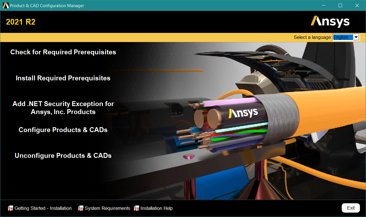

If not, run: ANSYS 2021 R2-> Product and CAD Configuration (right click and choose run as administrator)
Run through the Check for required prerequisites
If you are missung any run through the Install Required Prerequisites
Then run through Add .NET Security Exceptions for Ansys, Inc Products
