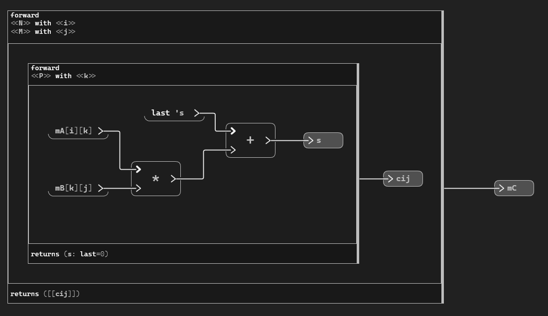

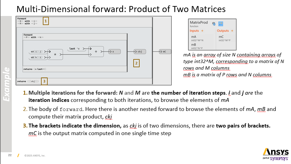

I am currently taking the SCADE ONE course and we found an error in the slides. The slides show the following:
However, using that logic, the order of operations to multiply the matrix are not correct. We reviewed the logic, and this is the correct version we propose:
It was just a matter of the matrix indices.

Ansys EmployeeHello,
You're correct. The implementation is the training slide is incorrect.
Your proposed solution is the good one.
I have reported the issue to our training team.
