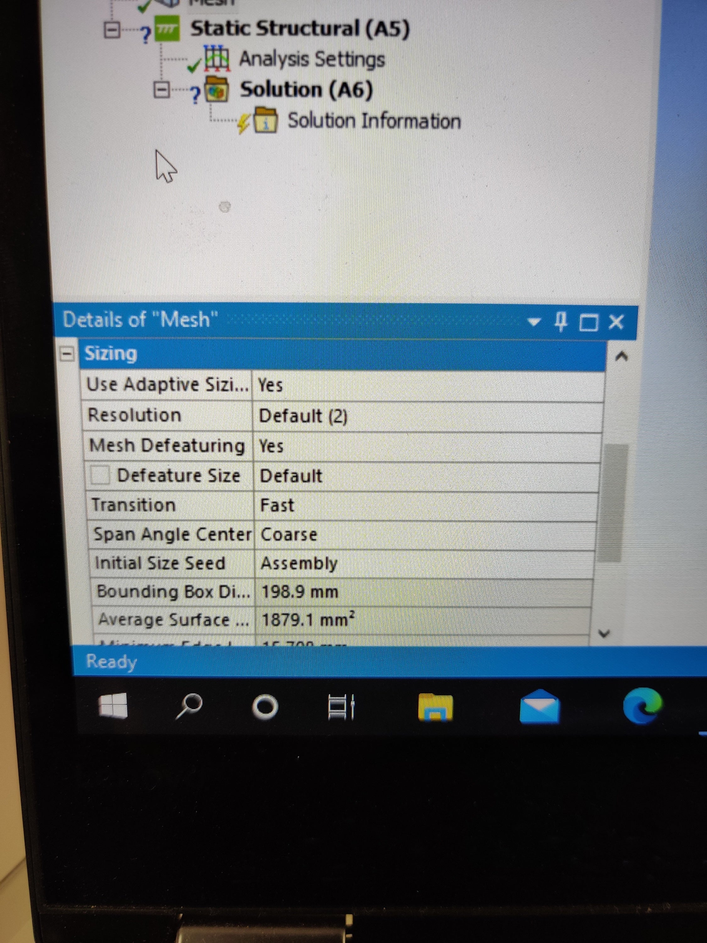

shreepatil14
SubscriberOctober 21, 2021 at 1:36 pmGovindan Nagappan
Ansys EmployeeRelevance was used to make default mesh size coarser or finer
In newer version, you can do that with the "resolution". Check documentation for more details on resolution
Or insert a "sizing" and specify the mesh size you want to use
October 21, 2021 at 7:14 pmshreepatil14
SubscriberThankyou
