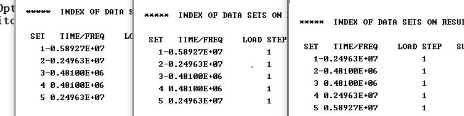

I couldn’t get the ideal answer when i try to do a lateral buckling example of I-beams
    • dyh1231
      I follw an analysing example that try to show the different bucking load when load on upper flange,centroid and bottom flange .which is achieved by "beam section offset"in MECHANICAL APDL
      the theoretical solution shows the different bucking loads are seperately 290KN,481.8KN and 800.5KN,but i got the totally same result that is 480KN when i use different section offset options the apdl code shows here.

      ! after run it seperately!
      The same Minimum positive value.

      So the lateral torsional like buckling (LTB) is likely captured and can be seen for 0.48100E6 - use /eshape,1 and also in the solution add:
      BUCOPT,lanb,5
      MXPAND, 5,,1E12,Yes
      to view the mode shapes of the buckling modes and one can then see that it is a LTB like mode for a value of 0.48100E6. I would compare this value to theoretical values say as per EC3 or other standards or other theoretical/analytical methods (perhaps you already have as you mentioned)
      Now if the offset will make a difference, I can not say (does not seem so, as you mentioned), but if it does not then the alternative is to use shell or 3D solid elements and that might give a difference depending where the force acts (top or bottom).
