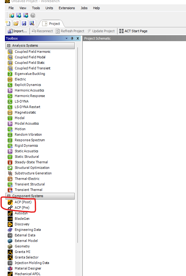

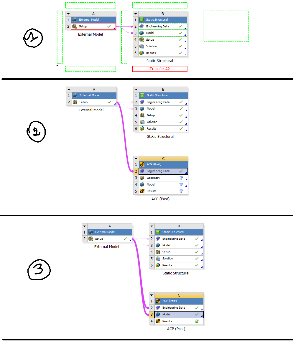

SubscriberI think you misunderstood my question. What I meant by I don't have pre-ACP is I didn't use it, I used an external model from APDL instead because my problem was i could not create a p=sin(x)sind(y) pressure in Workbench so i used APDL to do so
