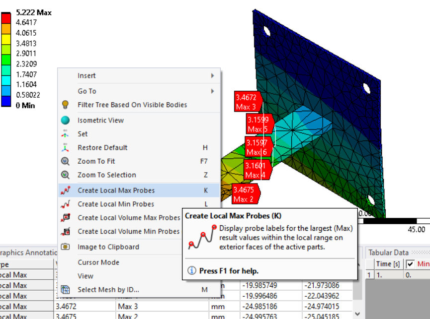

SubscriberSporadically, I have had several models that will not display Local Max Probes. I right click in the results window and select the relevant option but no tags are produced. I checked in Options>Graphics and set the number of probes to display to 10, but nothing. Has anyone had a similar experience and how di they resolve it?

Are you not getting the probes as indicated below?
