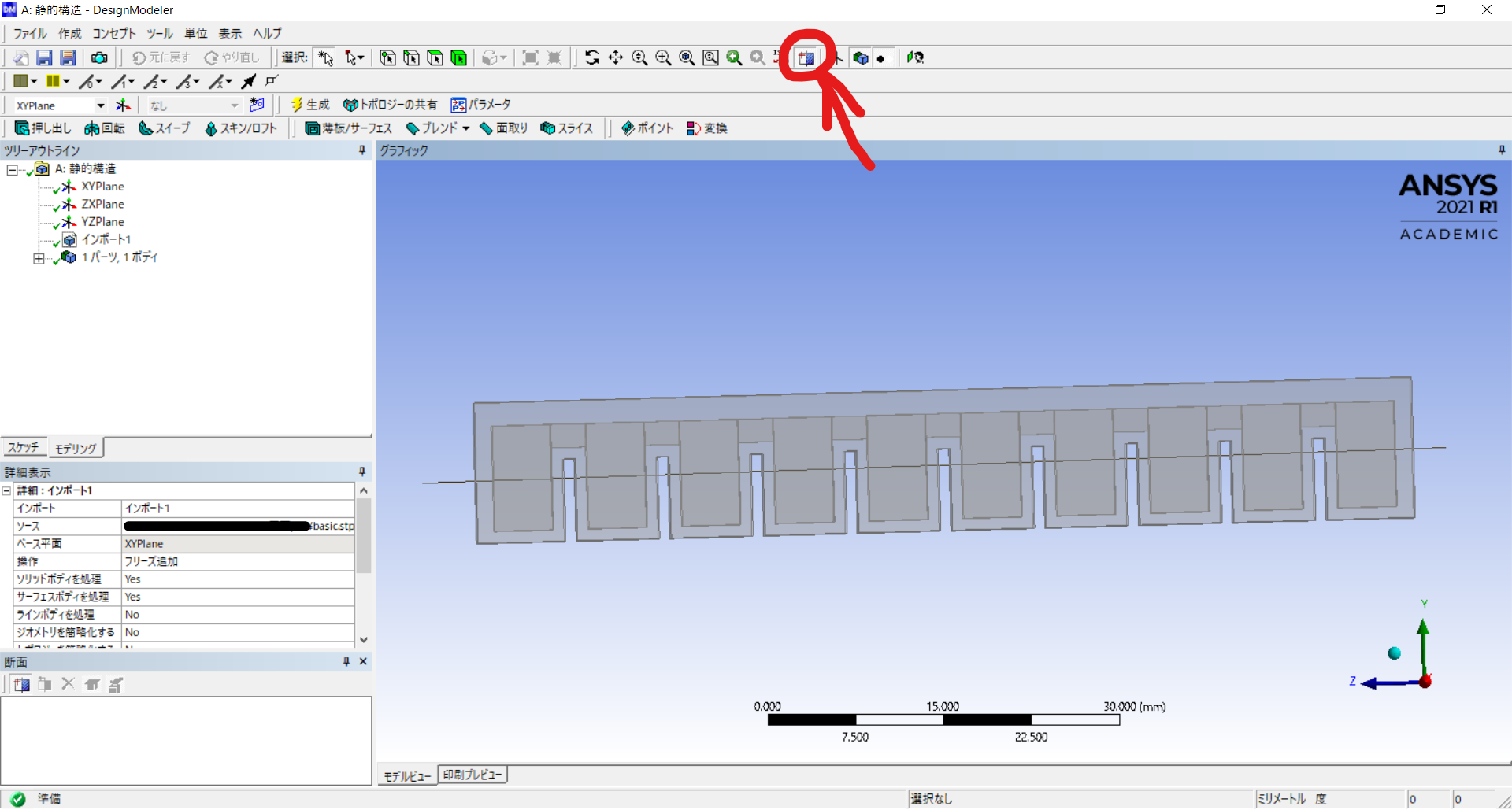

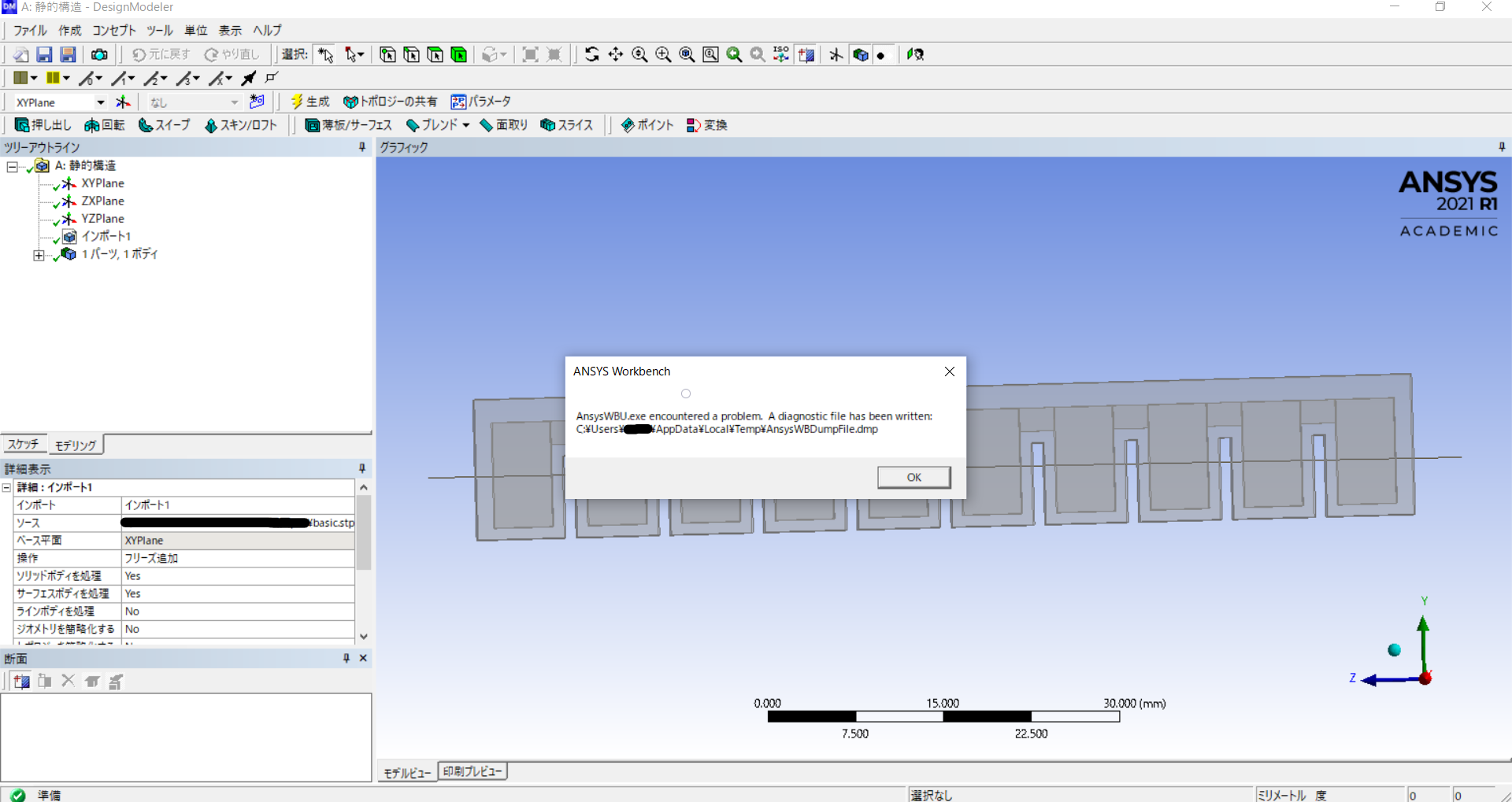

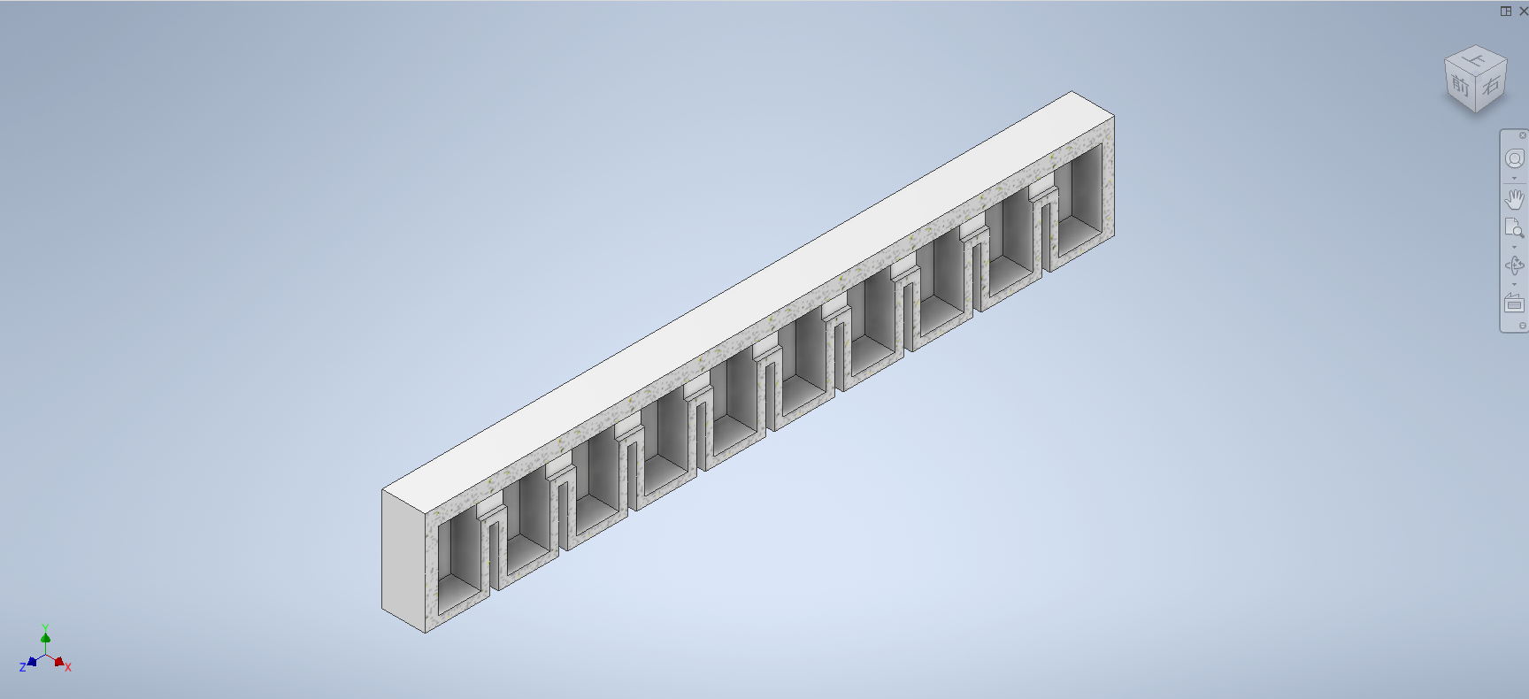

      I designed the drawing with Inventor, saved it as a file(.stp), and imported it into Geometry.I need to look at the cross section to insert pressure inside the object. However, using new cross - section with Design Modeler will cause problems with the software.The msg encountered a problem.A diagnostic file has been written: C/User/username/AppData/Local/Temp/AnsysWBDumpFile.dmp will be displayed as shown in the image For any object, the problem arises when I try to look at a cross section. The following is about my environment. software : Ansys Student 2021 R1nCPU : Ryzen 9 4900HS with Radeon GraphicsnGPU : RTX 2060 with Max-Q DesignnIf you know how to solve this problem, I would appreciate your advice

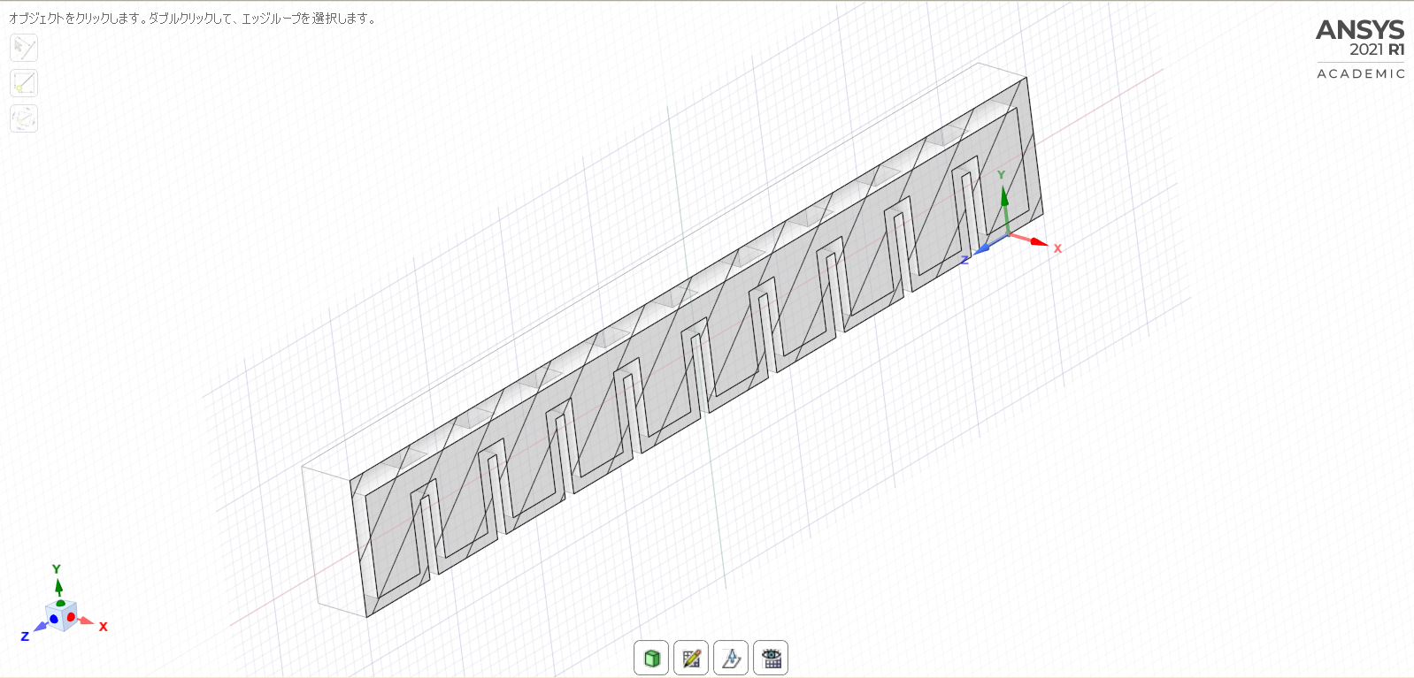

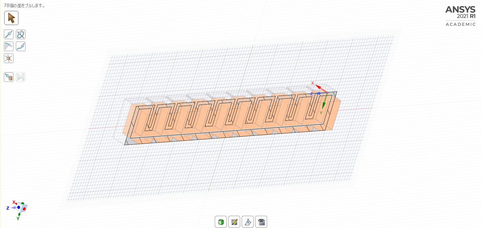

      I immediately tried it ... . However, the inside of the object appears to be entirely filled.
      I designed it so that the inside is hollow.
      I want to define the inner surface as that and apply pressure to it.

      Can you please try using other export formats (such as parasolid) and bring it to SpaceClaim?
      -Aniket
    • Shibafu
      I brought the geometry in parasolid (.x_t) format and it worked.
      Thank you for your response and advice.
