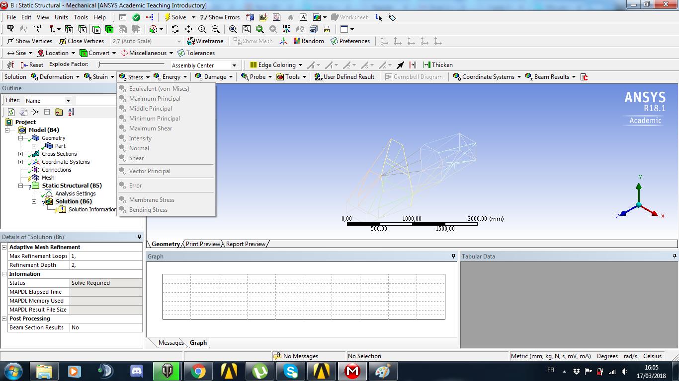

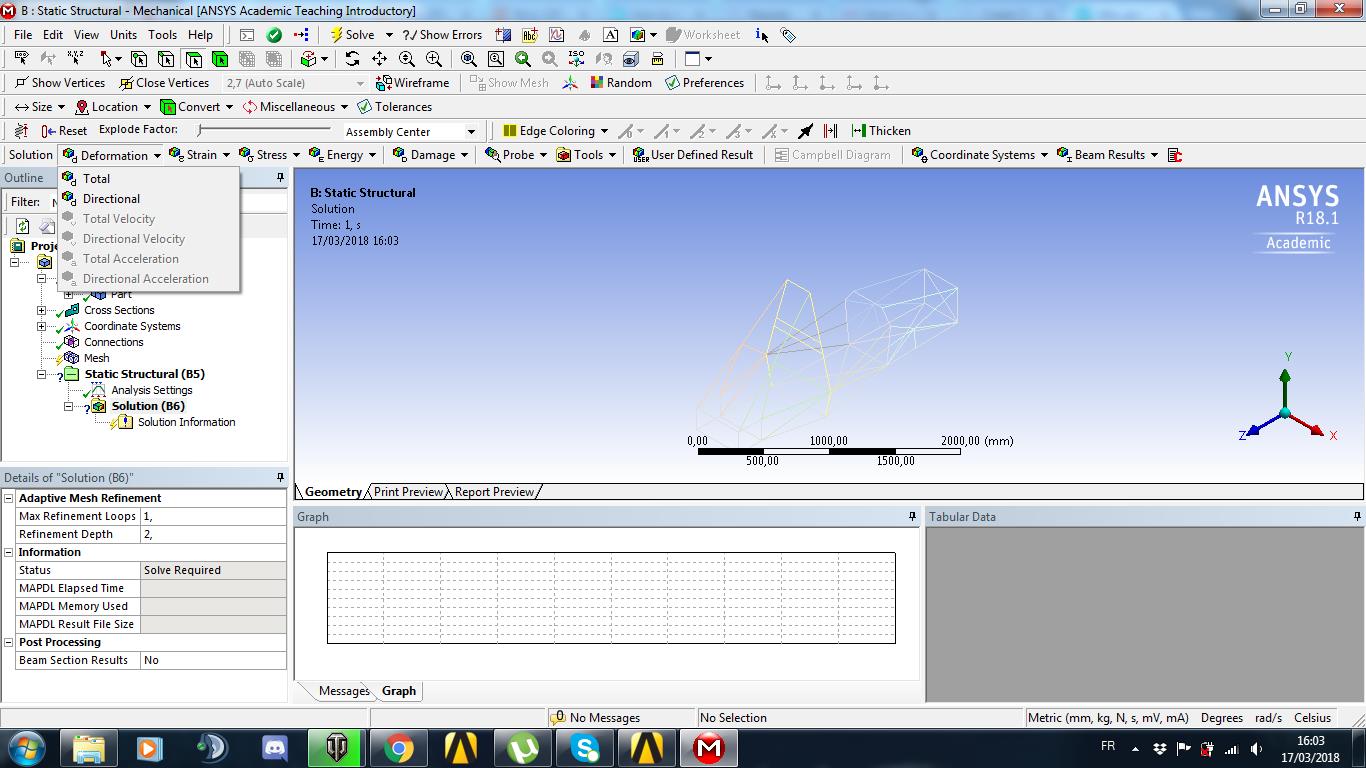

      Hello everyone.
      Since I'm working on my end of studies project , I have designed a chassis in DM made of points and lines with different cross sections as shown in the pictures I will provide.
      All is good until I went to Mechanical where as the title suggests I can only use 2 deformations while strain , stress... etc are unavailable.
      I thought the problem could be of my student Ansys version  18.1  , but turns out the software is okay since I tried mechanical with another simpler object and didn't have the same problems.
      Regards.
      Emir.

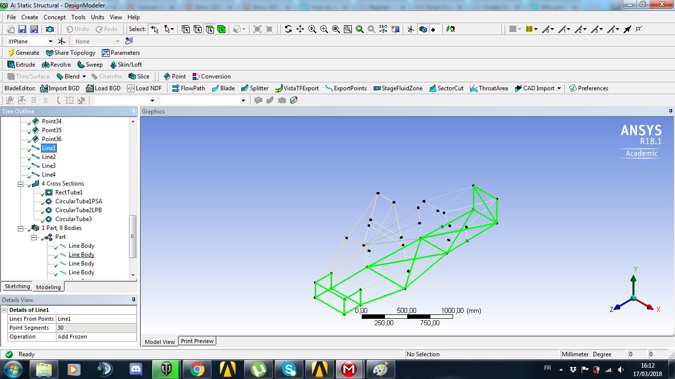

    • Emiros143
    • Emiros143
      The geomtery
    • Emiros143
    • Emiros143

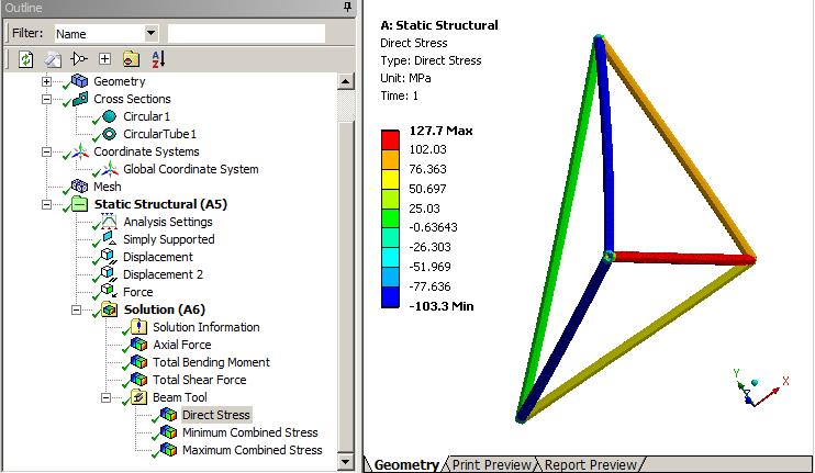

      Look past the Stress pull down and look in the the Tools and Beam Results pull down.
    • Emiros143
      Thank you sir that is helpful however the original problem is still the same , for example I still can't get the strain...
      You can calculate strain from stress because you know Young's Modulus, E.
            strain = stress/E
    • Emiros143
      Thanks very much Peter. I think the problem is with  the fact that I desined the chassis based on points and the fatigue tool therefore presents the same problem , appears in grey and is unselectable. Can you please provide me with geometry file preferably in design modeller so I can apply fatigue tests on it I really need this for my assignements.
      Thanks in advance.
      Hello Emir,
      Attached is a zip file that contains a Parasolid binary file of a car frame constructed of tubes. Open a new Static Structural, open DesignModeler, then use File, Import External Geometry File...
      This geometry comes from vaibhav jain where we were crashing the frame into a wall using Explicit Dynamics on a full license.
      Your problem Emir, is that on a Student license, this body uses over 100,000 nodes+elements using a default mesh, and the Student limit is 32,000. I don't know if you will be able to stretch the elements along the tubes enough to get under this limit.
      You can do fatigue calculations in a spreadsheet and put the stress results from your beam model into the spreadsheet.

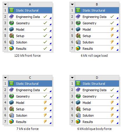

      Hello Emir,
      Thanks for your archive. I see you have four load cases.
      Do you have the number of cycles of each load that are expected?
      That is the next step to calculate a fatigue life for this chassis.
      Cheers, Peter

      Hello Emir,
      You can attach zip files to your posts on this site. So if you have data in Excel, or some other file format, put it in a zip file archive and attach that zip file.
      Your model had four load cases. The front force seemed like a front impact, while the roll cage seemed like it would be if the car rolled over. I don't think you want to estimate a fatigue life for those loads.
      The side load and oblique loads may be closer to loads experienced during a lap. One important choice in fatigue analysis is whether the load reverses, or does it go between zero and the maximum value. You have to say what happens during a lap. Maybe the lateral acceleration record of a lap will help decide.

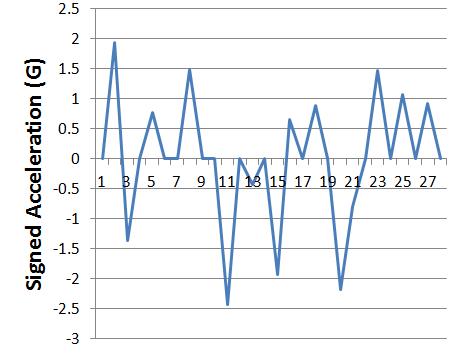

      Hello Emir,
      Looks like the course starts on the right and you are driving clockwise with right turn on R44 and a left turn on R62.
      Since most of the turns are right, let the right turns be a positive lateral acceleration and a left turn be a negative lateral acceleration.
      Use the course map and the lateral acceleration table to make a signed-acceleration vs turn history of the lateral acceleration for one lap.
      The cycles of left and right accelerations cause a reversal of stress that is important for fatigue. Fill out the rest of the spreadsheet.  Do you know how to count cycles?  Look up the rainflow method of counting. See if you can create a rainflow table of cycles.

      Hello Emir,
      So here is the graph of lateral acceleration vs course section.
      (After row 22 got the -1 that was mistyped as *1).
      Once you have studied Rainflow counting, count the peak-peak range and the number of half or full cycles, it looks like this after sorting:  Can you get this same table?   You can bin numbers that are close to each other and add up the cycles, so instead of 14 ranges, you can have 6-8 bins with a higher number of cycles. Please bin these numbers and provide that table.
      •    Range(G)  Cycles
      •     3.648     0.5
      •     3.067     0.5
      •      2.82      0.5
      •     1.933      0.5
      •     1.933     0.5
      •     1.933     0.5
      •     1.492      1
      •     1.467     0.5
      •     1.063      1
      •     1.058      1
      •     0.924      1
      •     0.766      1
      •     0.649      1
      •     0.423      1
      You can calculate the amount of fatigue damage each range does. A large range does more damage than a small range. Read about Miner's rule for Fatigue Damage. A half cycle does half the damage of a full cycle. In this way you can add up the total damage for one lap.
      The next step is to establish the load case that best represents lateral acceleration. If we have a 1 G lateral acceleration, with the wheels resisting the lateral force, what is the stress in the frame?  That maximum stress is what we can scale up and down according to the table above.  Please reply with your version of the lateral acceleration load and boundary conditions on your frame model.  You will need to represent the mass that the frame is supporting. Significant mass like the engine can be added as a point mass.  The rest of the mass can be distributed over the frame by assigning the frame a density calculated so the entire model weighs the same as the car.

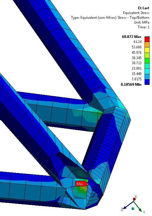

    • Emiros143
      Hello Peter.
      I have tried a fatigue run in the model and the rainflow and damage matrix don't seems to be giving me any logic results.
      the parts with surface elemnts are the parts I changed from beam to shell elements because they showed the highest stress during the static analysis while the entire chassis bean a beam model.
      it's attached here , the D static structural one with name " Last ".
      I'm finalizing my project but I'm stuck here , does this mean the cahssis will last forever?
      Thanks in advance
      Emir.
      Hello Emir,
      Why does the Fatigue Tool show a range of 0.8 to -1 when the data from above had a range of 2 to -2.5?
      Please explain how you came up with the two forces of 365 N (82 lbs) each. That seems low. I thought you would add several point masses to represent the engine and other massive parts and a lateral gravity load as I suggested above.
      You can't use this model to calculate the peak stress because the peak stress is on an edge that is used by a bonded contact.
      You want continuum or shell elements in the area of peak stress to get an accurate estimate of the peak stress. That means you cut out a section near that joint and replace it with solids and model the actual geometry of the weld fillets connecting the three pipes.
      I post this now and will look for an example to show you exactly what I mean.

    • Emiros143
      Hello Peter
      Thank for your reply , the range from 0.8 to -1 is what I got after normalizing the forces , the 2*365 N is the maximum force I calculated due to lateral acceleration ( ~-729N ) which I obtaiend by multiplying the top values of the graph in G's using the F=m.a formula. In previous example I used 2* 1N forces and used the history data unnormalized. ( values ranging between ~ -729N and ~580N) but the fatigue results where somewhat the same.
      I used another model to determine high stress point , it was the example with the full chassis in beam elements( Maximum stress determination right) with It I went to change parts of the chassis into surface bodies like you helped me achieve, from which I can insert fatigue tool adn study fatigue.
      It woukld be nice to add a point mass like the engine but I sadly do'nt know how to do such thing in mechanical, also do you think the displacements supports I put can interfere with the fatigue signficantly? I used fixed supports before but it made the chassis behave like a one beam so I canceleld that and went to use displacements while liberating the chassis from some axis like Z and X to try and approach the behaviour of the wheels resisting the lateral accelerations.
      I'm trying to understand the rainflow calculation method and I think I got it , however the values you provided here
