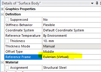

February 16, 2022 at 9:40 pmChris Quan
Ansys EmployeeTo use SPH particles and multi-material Euler solver in Explicit Dynamics system, you need to get the recent ANSYS releases.
To use multi-material Euler solver, you need to change the Reference Frame of the geometry body to Eulerian (Virtual). See the picture below. Then you need to look at the Euler Domain Controls under Analysis Settings to verify or modify the Euler domain settings. 3D mutli-material Euler solver has been available in Explicit Dynamics system for many years. 2D multi-material Euler solver is only available since the 2022R1 release.
To use SPH particles, you need to change the Reference Frame to Particles and use Particle meshing method under Mesh to generate SPH particles. SPH particles is not available to 2D analysis. It is only available for 3D analysis.
