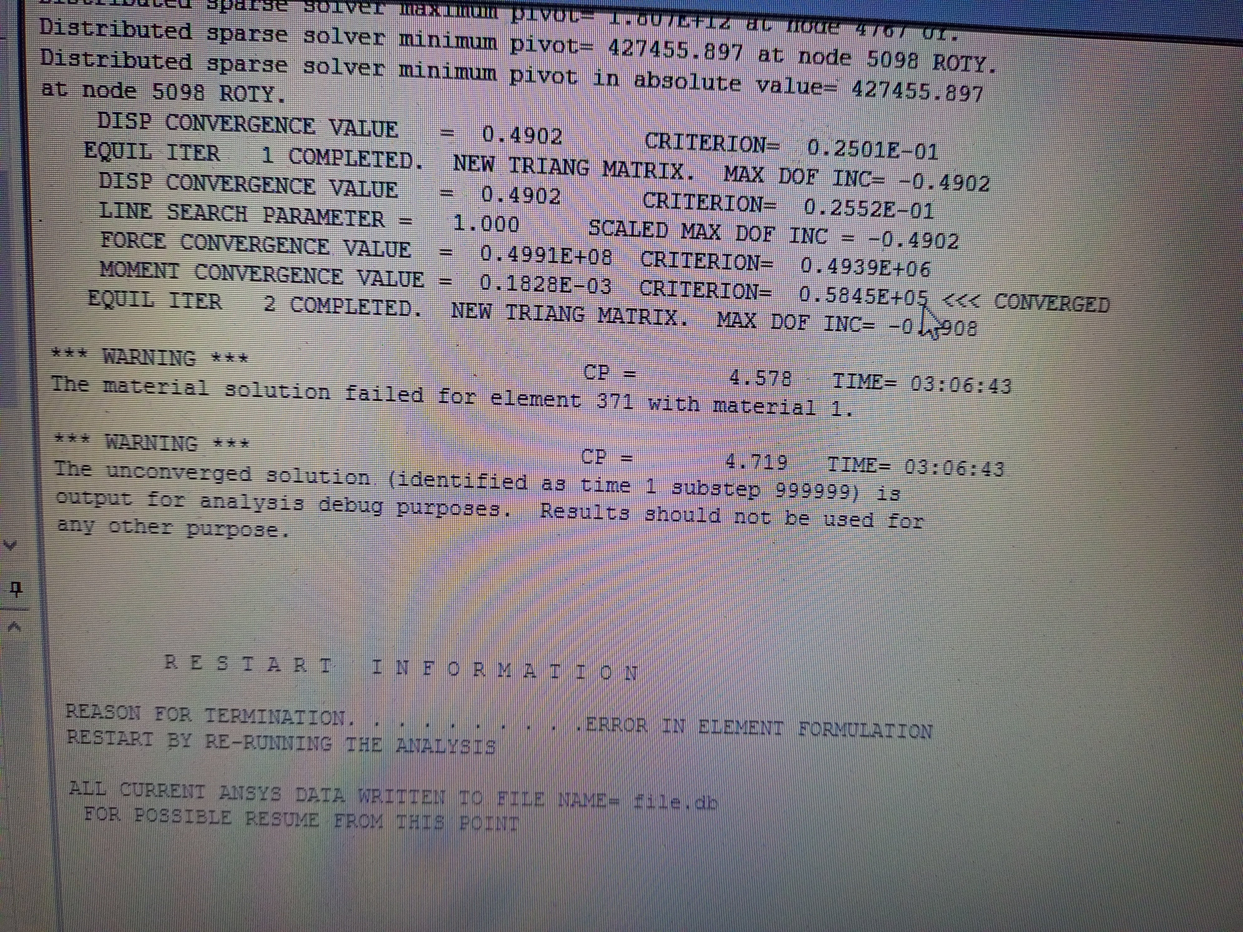

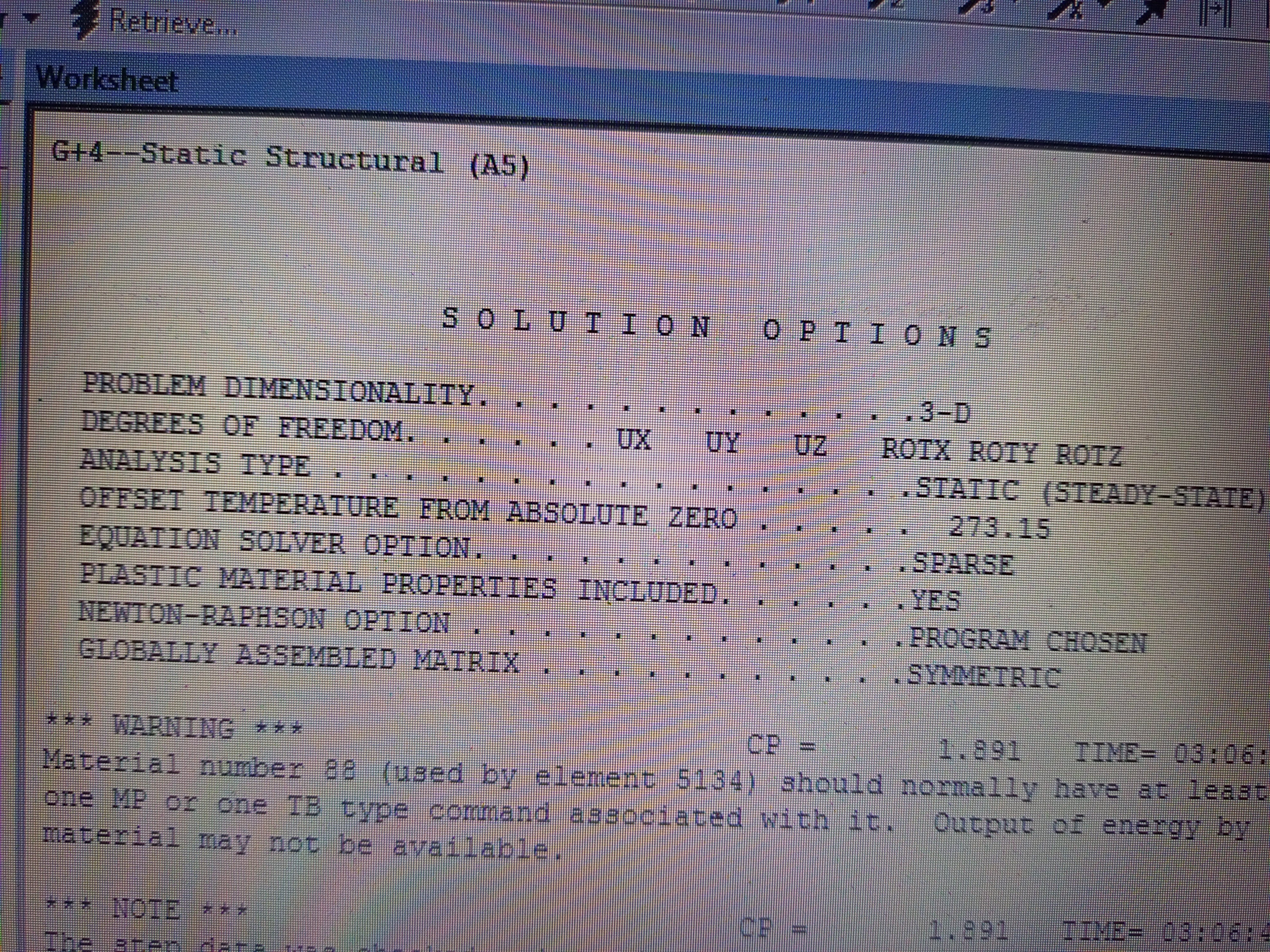

SubscriberGo to the Solver Output file, and search for errors. The source and cause of error most probably will be written there. If you cannot find anything useful there, then goto the folder where this ANSYS model is stored, and check for .err file. This might be helpful in diagnosing the error type.
October 9, 2021 at 9:45 pmOctober 10, 2021 at 1:40 ampeteroznewman

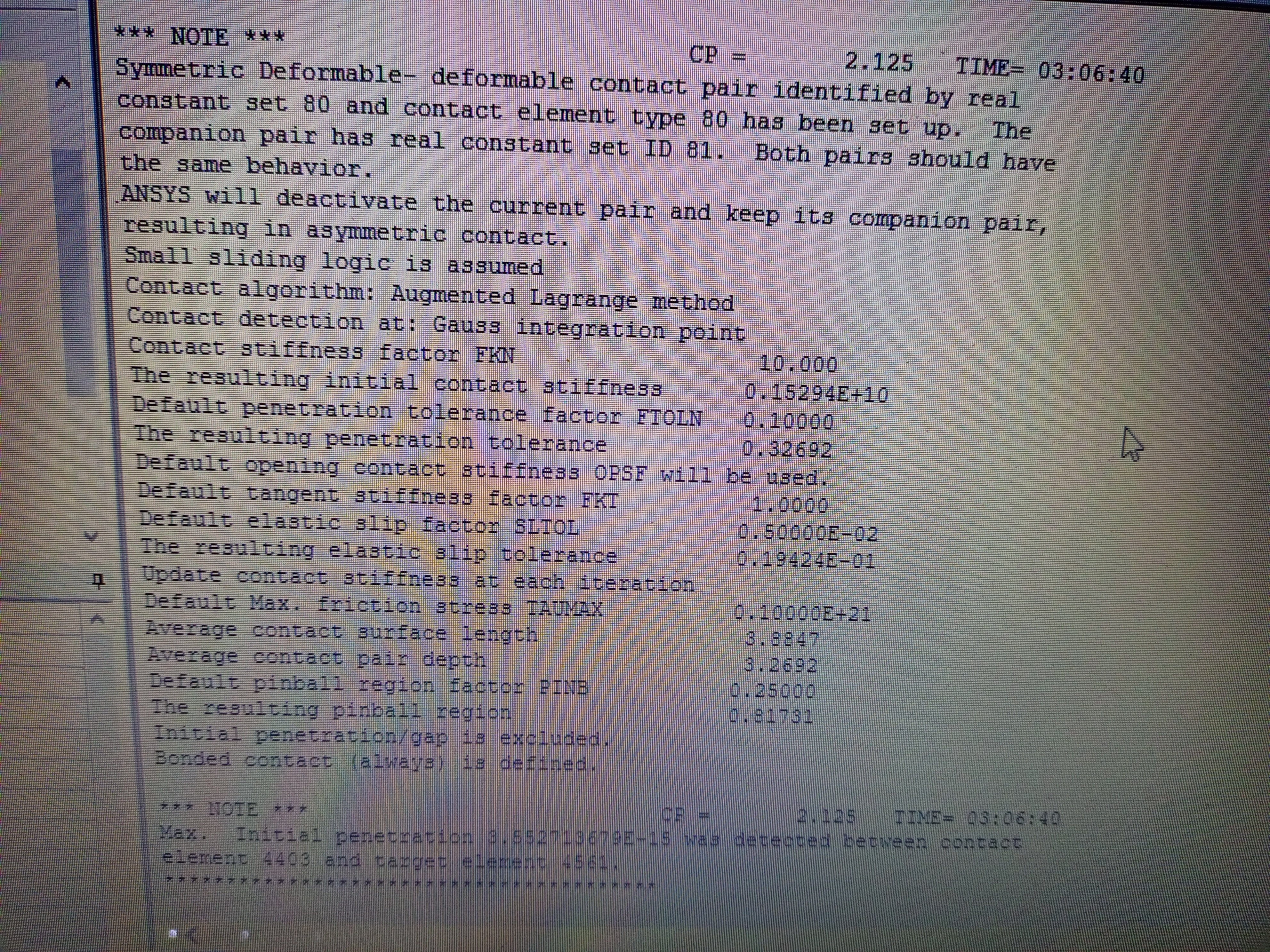

SubscriberPlease use the Snipping Tool to capture a screen snapshot for your reply. No more photographs of your screen, okay?

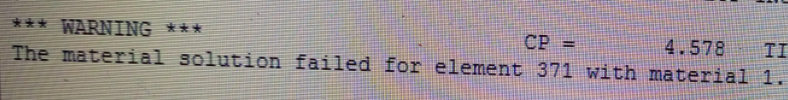

This is the error:

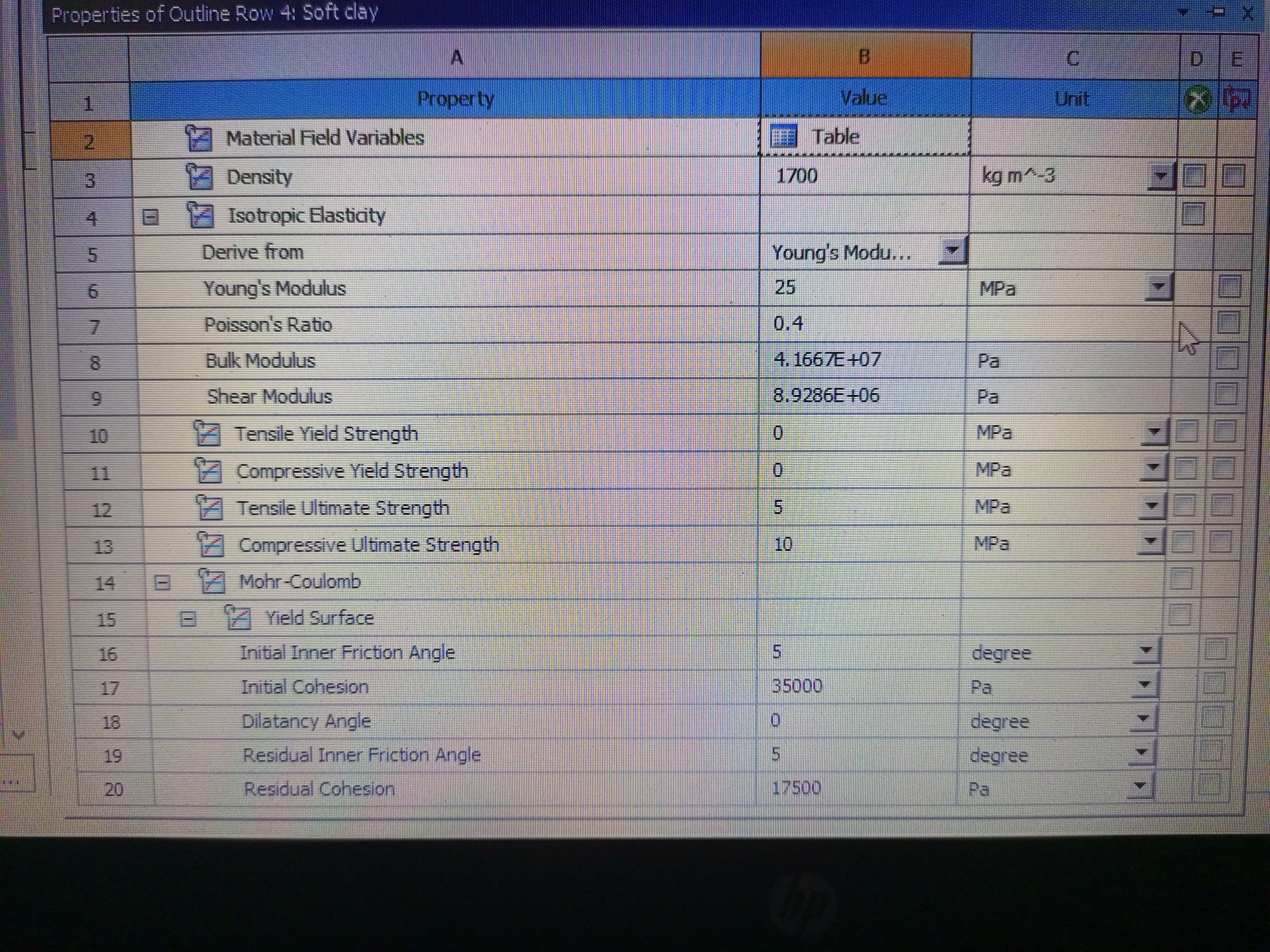

It means the Mohr-Coulomb material model had no solution.

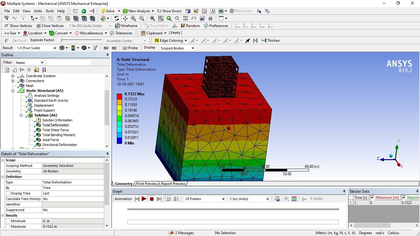

What boundary conditions do you have for the five sides of the soil block?
What is boundary condition B shown in the image?
Do you have a Gravity load?
Did you turn on large Deflection?
Did you turn on Auto Time Stepping?
What did you use for Initial, Minimum and Maximum Substeps?

Initially i was only providing the fixed support at bottom of soil face and not provided any boundary condition on the rest four sides. But now when i provided displacement on the rest four sides allowing displacement only in y direction keeping x and z direction displacement 0.
My static structural analysis model has perform the analysis but in modal analysis its showing the same error. Also the total deformation which is coming in static structural is high.
I have provided standard gravity load for both the analysis.
Large deflection is off for static structural.
In Static structural analysis why it is showing such high deformation and that same unknown error in modal analysis?

SubscriberModal analysis is a linear analysis so you can't use nonlinear material models like M-C. Delete the M-C and run with only Linear Isotropic Elasticity.
The deformation may be high in Static Structural because you have not turned on Large Deflection. Turn that on and see how much that changes the deformation.

SubscriberIt would be slightly more accurate to have two displacements for the sides, one that only sets X = 0 and another that only sets Z = 0 and instead of a Fixed Support on the bottom, that would be a third displacement of Y = 0. These may not make much of a difference as you make the solid boundary further away.
Don't plot Total Deformation, plot Directional Deformation in the Y axis. I expect that 0.15 m displacement is downward, is that correct?
Try meshing just a soil box with no raft in the model. What is the deformation then? Use that as a baseline to compare with the additional deformation when the weight of the raft is included.
You could begin the simulation with the soil prestressed with the state of stress from the gravity load using the INISTATE command. Look it up in the Mechanical APDL section of ANSYS Help. You can also find several posts on this in the forum. That way, when the simulation starts, the soil is already in equilibrium with gravity, and the only deformation is that needed to support the new weight of the raft.
Another approach is to use the information from the soil-only model for the vertical deformation due to gravity. Make a 2-step simulation where you have a displacement on the raft that moves it the same distance that the soil moves in step 1, then in step 2, remove the displacement constraint and let the raft sink further into the soil due to its weight. Now you can look at the difference in Y deformation between step 1 and step 2.
Try doubling the size of the soil box. Does that reduce the deformation?

No total deformation should not be that much. Even Directional deformation in y direction downward is 0.15 m which is wrong.
I will try with the suggestion given.
Thank you
October 10, 2021 at 9:10 pmpeteroznewman
SubscriberWhy do you say that the deformation is wrong? Have you tried putting a 40m cube of soil from the surface of the earth into earth orbit where there is no gravity? I predict it will expand along the y axis by 0.15 m when floating weightless in orbit.
As I mentioned, if you correctly prestress a 40 m cube of soil using the INISTATE command, when you run a simulation using standard earth gravity, the deformation at the surface will be exactly zero.
