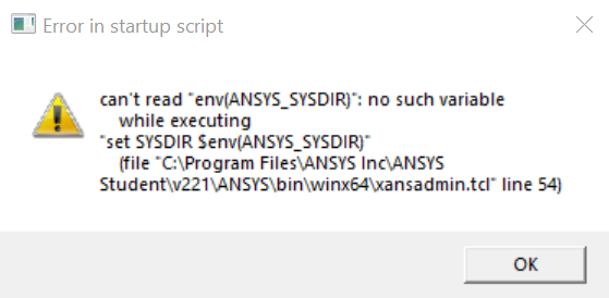

Can you try creating a new environment variable named ANSYS_SYSDIR with a value of winx64?
If you are not sure how to create one, please refer to this - How to Create an Environment Variable in Windows 10: 9 Steps (wikihow.com)
