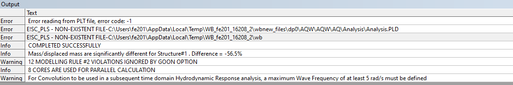

SubscriberAfter AQWA solver completes solution successfully .pld and .plt files are missing in solution.
January 6, 2022 at 12:05 pmVigneswaran Sridharan
Ansys EmployeeHey The error reported by Workbench suggests that the requested plot quantity does not exist in the PLT file.
There is a small possibility that you may encounter this error when adding new results to a project created and solved in an older version.
Re-running the calculation should certainly solve the problem.

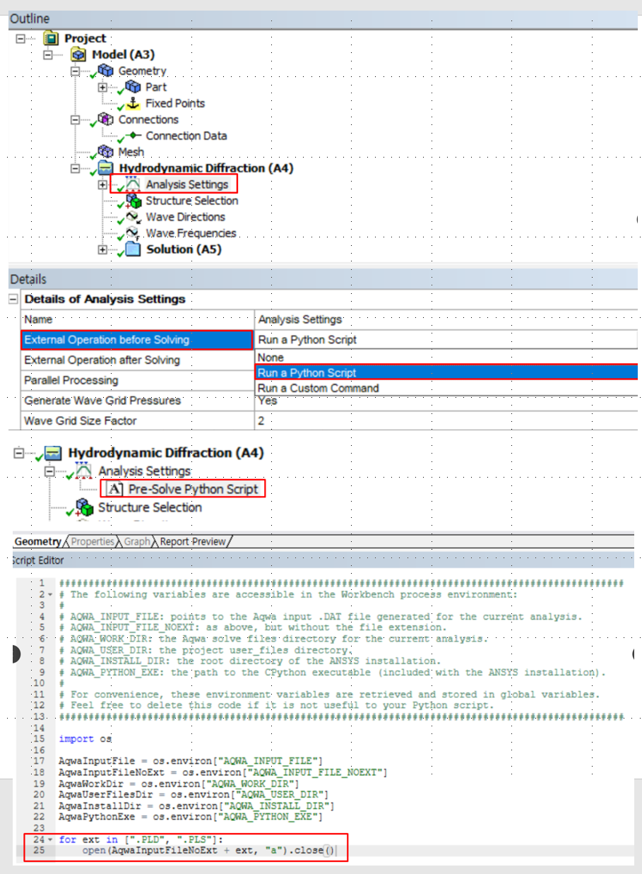

July 14, 2022 at 7:19 ameuui2000
SubscriberPlease use Workbench version over 2020R2.
It is not properly working under this version.
Follow the below steps.
- Open and Change the setting of External Operation before Solving.
- Set "Run a Python Script"
- Add this script in the generated file.
for ext in [".PLD", ".PLS"]:
   open(AqwaInputFileNoExt + ext, "a").close()
