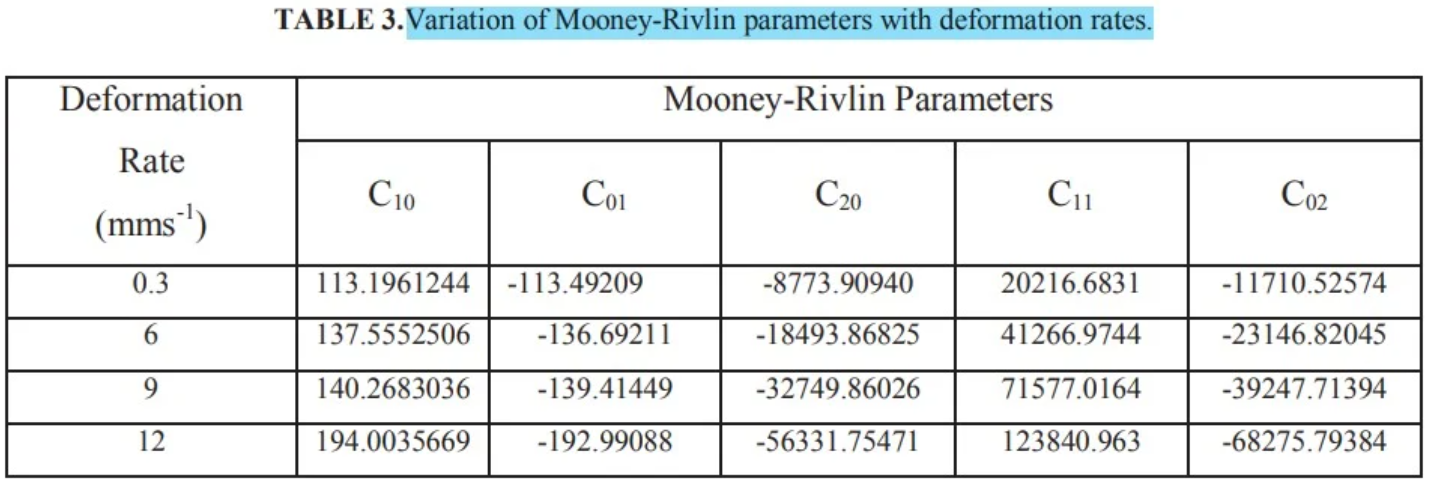

I need to use the 5 parameter Mooney-Rivlin model to simulate the hyper-elastic behavior of the human ACL. I've found a related article, which describes the model constants. Here is a picture indicating the table of coefficients: Â https://drive.google.com/file/d/1s2rwXOtdA8km24B52031RqN7wNZLEguU/view?usp=sharing
I have 2 questions:
1) Which value should i choose for the D1 (incompressibility) constant? Could (D1=0) be a proper value for ligaments or something near zero?
2) How can i enter the strain rate value for the constants? there is no place inside the engineering data module to enter this parameter.
Thank you in advance for any help.

SubscriberHi there. I Considered using (D1 = 0) for this material model, but i face errors (convergene errors, an internal solution magnitude was exceeded errors and etc.) at the solution status. I really need help and i will share the details and screenshots if needed. please help me! ?
