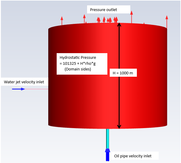

      I am currently working on a Volume of Fluid (VOF) simulation. The setup comprises two inlets: a vertical oil pipe and a horizontal water jet inlet positioned 5 meters above the oil pipe orifice. The domain takes the form of a cylinder with a diameter of 20 meters and a height of 16 meters. The oil pipe has a height of 5 meters, with 1 meter extending into the domain. The water jet pipe is positioned 2 meters away from the center of the oil pipe and extends to the exterior of the domain.
      I have simulated this scenario by specifying velocity inlets for both the oil and water jet pipes, setting pressure outlet at the top, and defining the domain sides as walls. Currently, I am exploring the utilization of a hydrostatic boundary condition on the domain sides instead of using a wall. This involves setting say a height of 1000 meters from the base (at 4 meters) to the top (16 meters). The reason is I want to model it in a more realistic way and may include a third phase: gas in subsequent simulations. i have written a udf that would distribute the pressure with atmospheric pressure at the top and increasing linearing down to the bottom of the domain. What is the right approach to hook this to the domain considering the physics and all the other boundary conditions specified at the inlets and outlet?

      Thank you, Rob. Initially, I implemented that with wall boundary conditions for the domain sides. However, my current issue is that I don't want the sides of the domain to be wall; instead, I want them defined by the hydrostatic pressure as atmospheric pressure + h * rho * g, with h set to say 1000 m. What boundary condition do I set the sides to in order to achieve this without using wall?

      Thank you very much Rob. That means I dont need to change the boundary type (wall) assigned to the domain sides? I have attached an image with the BC intended.
      You can change the wall to be a pressure outlet, and then set the operating density as discussed. In Fluent we're looking at the change in pressure, so unless the gas density is pressure dependent the actual operating pressure doesn't really matter.
      Depending on how the oil inlet and cross flow interact you may find you pull water in from the sides due to entrainment effects. I'd also be very wary of modelling 1km of domain without access to a lot of compute. The cell count is going to be VERY high.

      Thank you, Rob. I understand that. So, I modeled it with a 16-meter cylindrical tank. Now, I want the hydrostatic pressure distribution on the cylinder sides to simulate that of a 1000-meter height tank, where the top corresponds to the water surface (P = 101325 Pa).
