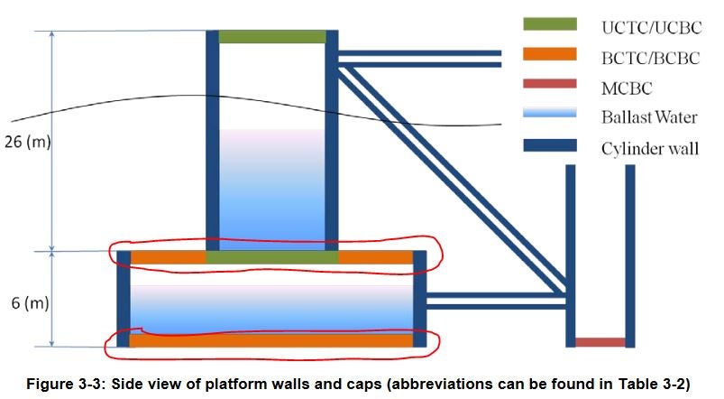

      I am in need of support to model the viscous drag from the heave plate/skirt of the attached platform using Ansys Aqwa. My queries are as follows:
      1. I am aware that "Disc" can be used to model drag force from a heave plate. But do i need two discs at 6 (m) apart (see the figure)? If I have to use two discs, what could be the 'Disc Normal' values along Z axis?
      2. If it is possible to model the drag effect of the heave plate using a single 'Disc', what could be the ideal location (along height) and 'Disc Normal' value (along +ve or -ve z axis)?
      3. Please be aware that in the upper part (where small vertical cylinder connects to the heave plate) at the centre of the heave plate there is a hole. how to model a disc plate with a hole in it?
       Cheers!

      there has been similar questions on the forum. You might be interested in these:
      /forum/forums/topic/ansys-aqwa-can-we-draw-a-heave-plate-like-a-line-body/
