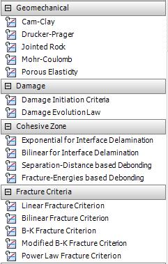

      Thank you very  much for your response. I see that the ANSYS has capabilities to model fracture initiation and propagation by using cohesive zone elements which I believe should help me to model hydraulic fracture propagation.
      I am a bit curious how ANSYS handles the pore pressure and in-situ stresses in the rock?

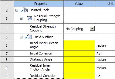

      In addition, I am also interested to know how the "Jointed Rock" model works. Does this model creates joints deterministically or stochastically?

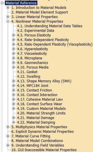

      Download ANSYS Student 18.2 (not AIM) using the button at the top of the page. Go to Prior Releases at the bottom to find 18.2.  There were some issues with the online help in 19.0 so it would be best to start with 18.2.  Unzip the download file to a local drive and Run as administrator setup.exe. Then you will have a working version of ANSYS that has a limit of 32k nodes+elements. Go to Help and search for Material Reference to see all the documentation on each material model.
