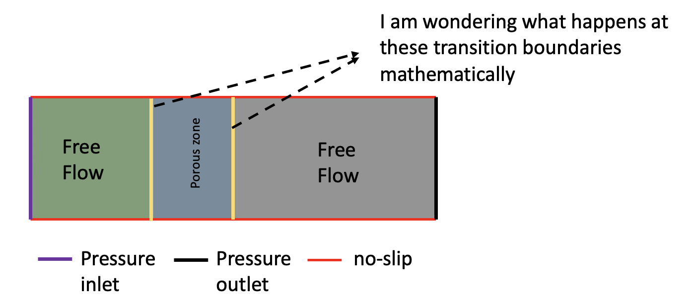

      I am wondering about the mathematics of pressure and velocity match at the transition faces from the free flow to the porous region and similarly from the porous region to the free flow region. In the below picture, at the yellow-colored faces how does ANSYS match velocities and pressures? I would be appreciated it if you can help me to understand this issue also if you can tell me which section am I supposed to be looking at in the ANSYS manual for my question. Which face boundary should I select, porous jump or interior?
      Have a look at porous zone (cell zones) and interior (boundary conditions). Porous Jump (boundary conditions) is worth reading too.

      I have checked all of them. But unfortunately none of them are answering my question. I understood that when we apply the porous media model to the cells, it simply adds a momentum sink to the Navier-Stokes Equation in terms of pressure drop. My question is, when the coefficient matrices are calculated for the finite volume solver, are those matrices prepared separately for both porous and free flow cell zones and solved separately? If so, how does the coupling mechanism work?
      Another question:
      There were not enough information for interior type face boundary in ANSYS manual. What does it do mathematically? How is this face boundary incorporated into the finite volume solver? Could you please give me a reference link. Any help is appreciated :)
      The matrix should be for all cells, we don't couple the porous media as such. However, this may not be fully covered in the manual, and I'm not permitted to expand on the documentation.
      Interior is a geometry surface that's meshed and brought into the solver. A good example is the CAD face that exists between two volumes. Flow will pass though this surface (it doesn't do anything) but it's useful in that we can run monitors etc on it with more precision than an iso-surface or plane. There won't be a reference as it's just a label. The "other" interior surface(s) contain all of the facets for the cell volumes.

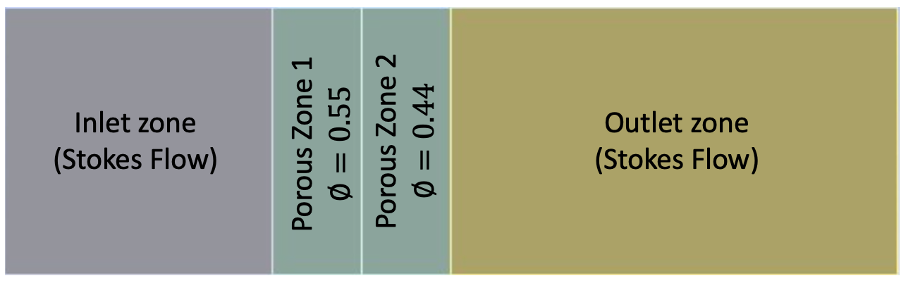

      So as the last question:
      As far as I understood, assigning a porous jump boundary condition to the cell faces is meaningless when the cells are already defined as a porous medium, am I right? Therefore interior boundary condition will be enough for those cell faces. Similarly, when I add two porous zones right next to each other (which have different permeabilities and porosities), the cell faces that separate these two zones will be defined as interior instead of a porous jump for a more realistic model that represents the flow dynamics for permeability variation between two zones? (See below figure).
      That's not what you asked. If you have a porous media you can either have a porous jump OR interior on the bounding face. If there is no additional resistance and you're not needing a surface to catch particles then interior is correct. If you want a membrane (eg perforated plate covering a filter) or want to catch particles then porous jump is the correct choice.
