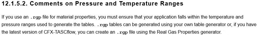

SubscriberIs There a Provision in AnSys Fluent To Add Custom Made Tables (Let's say for around 500 Data points{Piecewise Linear Method}) for property Variations? -
January 14, 2020 at 5:58 am
DrAmine
Ansys EmployeeYou can code an UDF to read from file, interpolate then assign the material properties. Other way is reading Real Gas Properties in Fluent. Check recent beta feature Manual. -

SubscriberHow to input Properties of Water in Near Critical region, where props vary w.r.t to pressure and temp (USING RGP TABLES) ?
Tried Using Commands as per Manual, props not matching with NISTÂ WEBSITE DATABASE..
REGARDS
February 3, 2020 at 10:03 am
DrAmine
Ansys EmployeeYou need then to check from where you got your RGP tables.
February 3, 2020 at 10:21 pm
alexhathway
SubscriberWe did not Use RGP Tables, We used The Above commands .. Props Not Matching with NIST
As ANSYS Officially Does not provide a Software for Generating RGP Tables, We aren't Aware, How to Generate RGP Tables.
And I am Not sure Whether RGP tables also accounts for Density Variation as Well.
If There is any Official Platform to generate RGP Tables, Do Suggest me Sir. It will be Helpful
Thank You
February 4, 2020 at 5:56 am
DrAmine
Ansys EmployeeThe generation of rgp table is described in the beta feature Manual. -
February 7, 2020 at 2:25 pm
alexhathway
Subscriber1.Is There Official Video Tutorial for RGP Files Generation?
2. Can Density also Be Added into RGP Files, Can We Chose the Properties we Want like specific HEAT, Viscosity and Thermal conductivity?
Thank You Sir -
February 7, 2020 at 2:35 pm
DrAmine
Ansys Employee1/No official video.
2/You need to read about RGP tables in the CFX Help: it does describe what it is included in the file: for sure density, and all other thermo/transport properties.
February 7, 2020 at 9:23 pm
February 8, 2020 at 6:06 am
DrAmine
Ansys EmployeeIn beta feature Manual of Fluent you can read how to create RGP tables. Definition of RGP is written In CFX guide.
