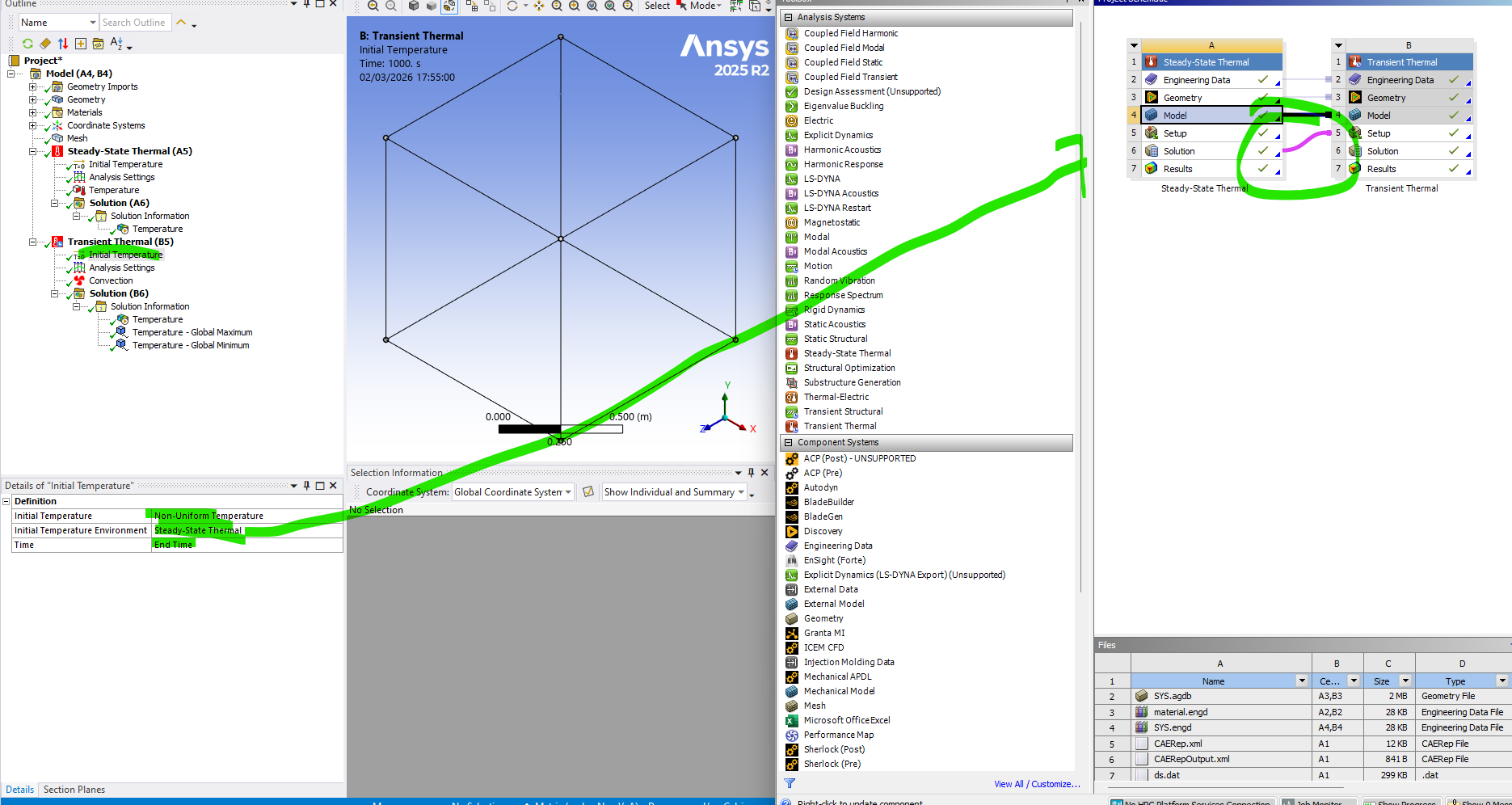

      I want to use the results of a Steady-State Thermal analysis as initial condition for a Transient Thermal analysis. I have them connected in Workbench but I can't seem to find an option to use the temperature data.
      Any help is appreciated.
    • ErKo

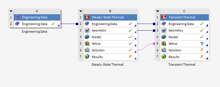

      Linke the two first – see right image below

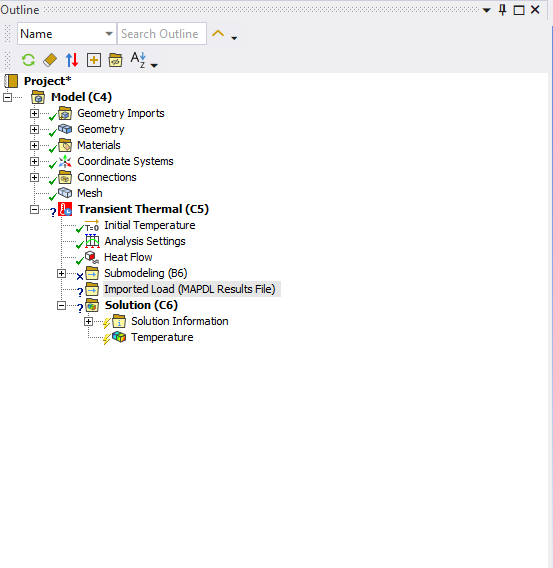

      It is under Initial Conditions / initial temperature (left image below):
      More info:
      https://ansyshelp.ansys.com/public/account/secured?returnurl=/Views/Secured/corp/v252/en/mech_obj/ds_initial_temp_o_r.html?q=initial%20temperature
      See below for details
      All the best
      Erko

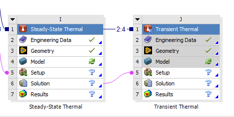

    • Raman Babu
      Please have a link between system I & J till the solution cell, as shown below.

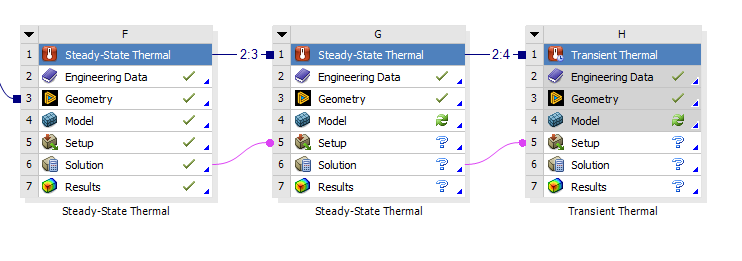

      If you want to have a different mesh during transient analysis, please remap steady state results to another steady state analysis having a different mesh, which later on you can link it till solution cell.
      Please try it and let me know how it goes.
