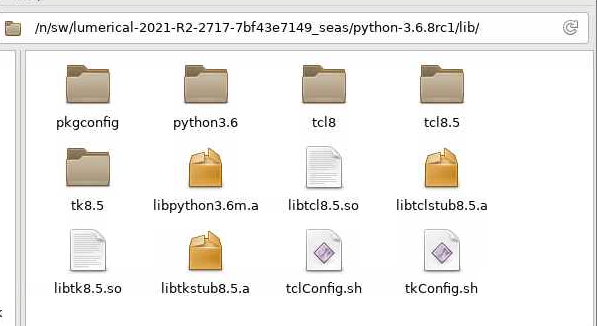

      Hi, I am using Lumerical installed on a computer cluster at a school and accessing Lumerical via a virtual desktop due to license related issue.
      In this type of setting, I am not sure how to use Python API, especially lumopt. When I try to run a Python script from the script editor, it shows an error message like this:
      "Python integration status: inactive
      Executable: Executable gnome-terminal or mate-terminal is required to launch a Python interpreter, but was not found in PATH."
      An article (https://optics.ansys.com/hc/en-us/articles/360050995394) says that I can directly run the examples by running the scripts from the script file editor in the CAD. However, I am not understanding what this means. Would you please give some advice on this problem?
      Thank you!

    • Ariel Lee
      Thank you for the reply. I am using Python in Linux, and my environment already has xfce4 terminal. Is it possible to use this terminal instead?
      Also, when I go to the “Help” tab and “Python Integration Configuration”, the Python integration status is inactive.
      The “Use Python provided by Lumerical” option is checked, but the path directory shown on the tab does not exist. The path shown on the tab is: “PYTHONPATH=/n/sw/lumerical-2021-R2-2717-7bf43e7149_seas/api/python:/n/sw/lumerical-2021-R2-2717-7bf43e7149_seas/python-3.6.8rc1/bin:/n/sw/lumerical-2021-R2-2717-7bf43e7149_seas/python-3.6.8rc1/lib/site-packages”
      but actually, the directory under “lib” folder is as shown below.
      How should I fix this to make the python integration status “active”?
      Thank you in advance!
    • Priscila Romagnoli
      Hi Ariel,
      It is required to have a Gnome or Mate terminal for using Python with Lumerical in Linux, please install it.
      In addition, you can check the path in which Python and Lumerical are using, as described here: https://optics.ansys.com/hc/en-us/articles/5771091294739
      And if the path is not correct, please add it in the environment variables in Linux, as described here: https://optics.ansys.com/hc/en-us/articles/7595785040403
