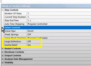

In the latest release (2021 R2), the documentation says that it can be used for both linear and nonlinear analysis.
(SO it should be possible in 2021 R2)
Search for 14.2 Interia relief, and under the theory reference in the 2021 R2, for more info.

Subscriberhi I using ansys 2021 R1. Is it possible to fix the problem with this version?

Check the 2021 R1 help manual, and the section I mentioned and check under limitations (it is not possible to do this in 2021 R1, only in 2021 R2 and onwards I believe - please check the limitations as mentioned).

SubscriberI checked but unfortunately couldn't find it. Can we do this with a different analysis method?
August 20, 2021 at 11:15 amErKo
Ansys EmployeeWell, you did not check properly. Chapter 14.2 Inertia relief in the help manal (Theory Reference part).
As we said inertia relief can only be used from 2021 R2 and onwards.
Can you please explain what you mean with this in the your message above, and with a different analysis method. It is not really clear so please explain what you want to do, but if it is inertia relief in a nonlinear analysis (large deflections), as we said it can only be done in/from 2021 R2.

Ansys Employeeactually I am not sure it even works in 2021 R2 :) - sorry about the confusion.
Need to investigate a bit more to see if it is possible.

Subscriber,can you please give me a general idea that why inertia relief is only possible with the linear analysis and not non-linear? I checked the section 14.2 and it just mentions the inertia relief limintaions there but the reason is still unkown to me.
I mean what kind of non-linearity cannot be used with inertia relief? Frictional, geometric and material non-linearity, all of these will not permit me to use inertia relief with it together in the analysis?

Unfortunately it is not clear to me either so I can not help (perhaps someone else can) - what I would recommend is to use inertia relief with linear analysis - inertia relief was say applied for free floating structures, e.g., in ship strength analysis (global analysis of a ship) and it is then used with linear solvers.
