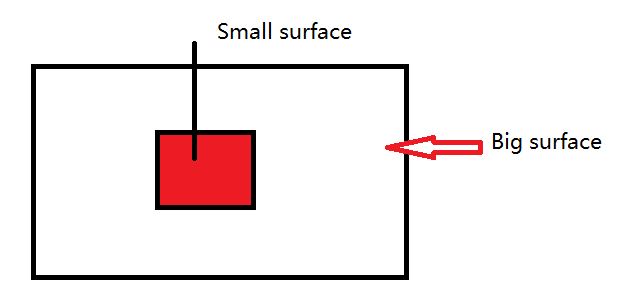

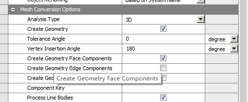

SubscriberI have an ansys classic model, and export to cdb file which including nodes components. The I use external model to import the cdb file, and I have select to crest Gemotry Facce Components, but some nodes compnents can't creart the surfeace, for example a small part of a big surface. So how to use the nodes name selection to creat contact ?The defaut contact use the geometry face, is there a way to choose a node name selecction to creat contact ?

In Workbench External Model, there is an option "Process MESH200 Elements". This is turned off by default, so you have to turn it on. If you are using an existing project, right-click on External Model system to 're-read data files', so the new CDB file will be read in.
In the linked Mechanical system, ensure that you have "Create Geometry Face Components", as you have shown in your screenshot.

November 12, 2021 at 3:29 pmNovember 12, 2021 at 3:40 pmSheldon Imaoka
Yes, you can do what you noted in your reply. Define MESH200 with the appropriate keyoption - for example, if the parts are meshed with 10-node tetrahedral elements, you can use "ET,10,200,5" to define element type ID #10 as a 6-node triangle. Select the nodes either on the small surface or big surface (pick one), then, use TYPE,10 and ESURF to create the MESH200 elements. If you follow the steps outlined in my earlier reply, the surfaces should be separate when you import into Mechanical.
