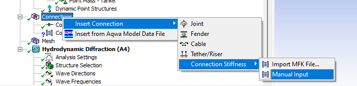

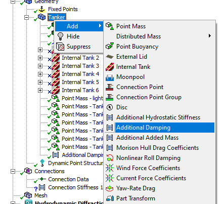

      Hi, I would like to use externally calculated dimensional mass matrix, mooring stiffness matrix and a frequency independent damping matrix for diffraction calculation in AQWA. The purpose of using these matrix is to calculate QTF considering the first order motions of the body. I want these matrix to be used during the first order motion computation of the body. Could you please guide me on how to input these matrices properly either in AQWA workbench or command line input file, *.DAT? If you need further information, please let me know. Best regards,

    • Shuangxing Du
      In AqwaWB, you can use Point Mass to define the mass and 3x3 matrix of moment of inertia,
      The mooring stiffness matrix can be defined or imported by Connection Stiffness
      The frequency independent damping matrix can be defined by Additional Damping (Frequency Independent)

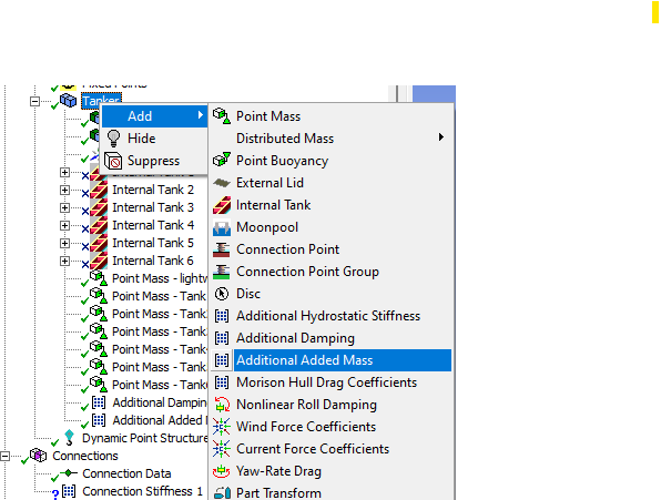

        Hi Shuangxing Du,
        I was just wondering how AQWA would incorporate the marked terms in inertia matrix?
        regards,
    • Shuangxing Du
      Aqwa cannot input these terms directly. However you can input them by the frequency independent added mass matrix.
